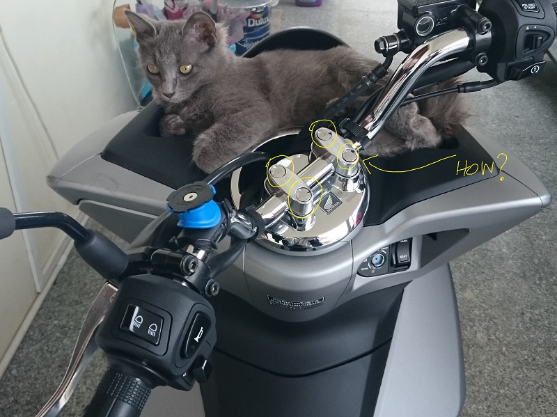

I am in the process of deciding which RAM Mounts components to get, and for the base I kinda like the handlebar clamp base. But first I'd like to know how to remove the bolt cover the proper way without damaging anything.

Myself and others asked this - someone said you could place sticky tape over them and pull them off - not sure how you would remove the cat, that can be even more tricky
Re: Handlebar bolts cover removal
Posted: Mon Oct 17, 2016 8:38 am
by homie
Yes, get the very stickiest duct tape or buy a small roll of gorilla tape. Work the tape over each cosmetic cap getting into the outer edges with your finger nail as deep as possible... rip off. Then be prepared for some of the tightest hex drive bolts on the PCX. Use a top quality drive and extended leverage (impact wrench) perhaps to loosen. I did this to push up the bars for a more comfortable riding position and the caps are a snap but the bolts are a BEAR!

One more thing, the description on Ram mount says "Have an M8 by 25, 30, or 35mm handlebar bolt?". Is it safe to assume the ones in my PCX are M8 bolts in one of those lengths?

They are a pia to get off, I used a jewelers flat screwdriver to pry off easily.

My SM does not mention handle bar removal, fastener sizes or torque values for the 4 bolts. The instruction above was trial and error. I think people destroyed the caps before asking for assistance or using tape. Good use of this forum to ask.

Yes, use pieces of sticky tape and apply as mentioned. But first fold a corner down on each piece so you can use it to pull each cap off. A quick pull at that
Once you've exposed the for bar bolts try using this set-up. It worked easy peasy for me.
I used a 6mm hex drive head and ratchet. "Before" you're ready to set those bolts back in, apply a dab of loctite to their threads. Good luck!

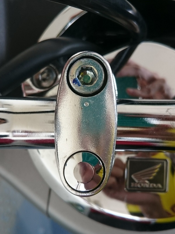

That was easy. I first tried using cheap ordinary tape (not sticky enough), and then tried to pry using bicycle tyre lever (not thin enough). So before trying to find a stickier tape, had to try prying with a sharper object: cutter knife.
- DSC_0001.JPG (161 KiB) Viewed 7999 times

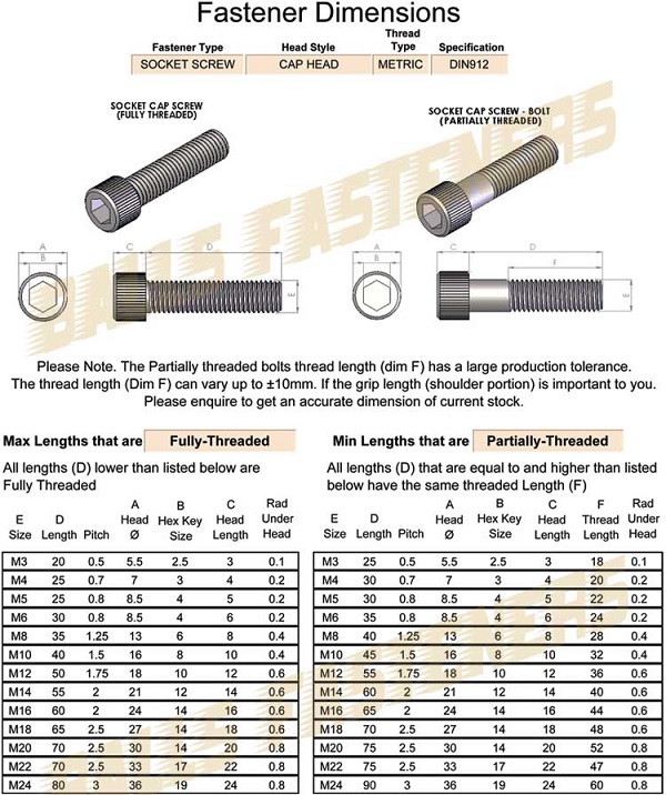

No luck with bolt though. Only had my bicycle multi-tools with me, that would just break apart if I turned strong enough. Anyways, good news is that it seems we have M8 bolts if I got my info right..
- 6mm hex size means M8
- Socket-screw-cap-head-allen-bolts-dimensions-fasteners-metric-4.jpg (172.25 KiB) Viewed 7999 times
