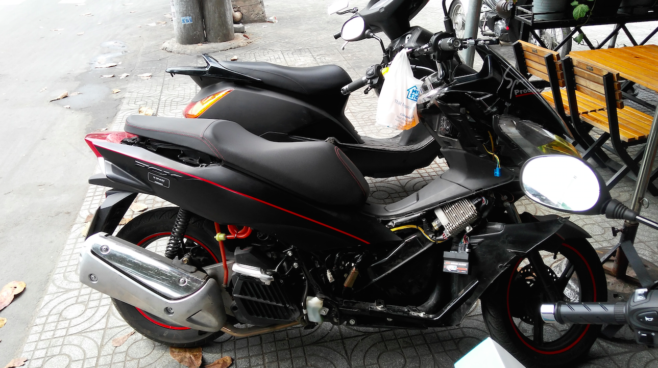

Let me get straight into the point.
We have perfected the standalone ECU for the PCX125/150 LED models. Wiring is the same from both models, I've checked. Brand is familiar, APITech.
Let me explain a little. The problem with making a standalone for the PCX125/150 is that the stock ECM handles both starting and recharging the battery. Therefore, you cannot completely drop it. APITech went the other way, it will let the ECM start the engine and recharge battery, but that's the end. Everything else is fully controlled by this 9.0 APITech standalone. Which would mean that you have complete control over your engine's behaviour. I don't know about you guys but I would choose a standalone over a piggyback any day.
The picture is from my friend's PCX125 LED, with a Char Mo 61mm piston kit, stock camshaft, Forza 300 exhaust, 31mm TB, CBR150 injector with the standalone installed. The difference between tuned and no tuned by the standalone is like night and day. One thing that is amazing about this is the fact that it can control the injection timing too. Which means that if you are smart enough to know when the intake valve opens on a certain crankshaft degree, you can change it so that the fuel is sprayed exactly during the intake valve opening duration or so. Remember, since it is a standalone, it has full control of everything.

If it's some sort of resistor to change the injector pulse width it will be interpreted as a faulty injector by the ECU if you change it too far. The owner of the bike in the picture used a Takegawa controller in the past. Runs funny as shit. It runs 1 way during a rain, 1 way in the morning, 1 way in the afternoon, 1 way in the evening. All with the same setting. Hence the need for that standalone.
