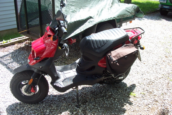

Funny you should mention about the wind drag with the saddle bags. I notice that right away the first time I put them on my R50. And to add insult to injury when I wear my bulky winter jacket it tends to bog things down even more. . .not to mention totally block my view in my mirrors. I have to raise an arm to be able to see who's behind me or turn around. That is another reason why I like the PCX . . .better rear view mirrors. :geek:
