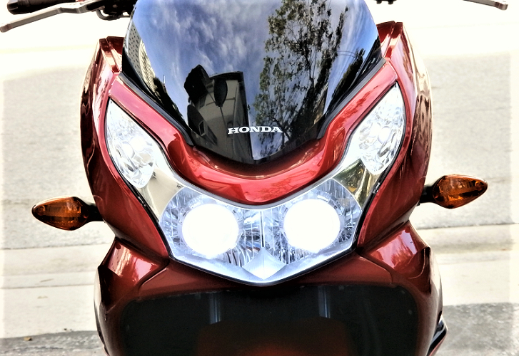

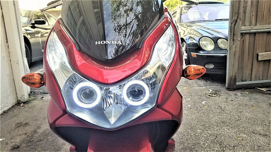

I did it with mine by drilling then filing cutouts for 1156 bulb holders in the headlight rear and reflector shell. Not a quick job as the headlight has to be removed and split by oven baking or a heat gun, otherwise you'll likely have bits of plastic from the process stuck in there. I did mine along with an H.I.D. projector retrofit using 1156 LED cree spots to a remote on/off switch. See pic. From further away and at car driver eye level the cree's are extremely bright even in daytime
- pcx hi beams.png (684.95 KiB) Viewed 1689 times
- pcx halo 2.png (1.12 MiB) Viewed 1691 times

Thanks! A little hard to tell from those pics. I have no interest in the headlights themselves, just the lights above and behind the headlights. The place where civilized countries mount the turn signals. Is it a major project to remove the headlight assembly? I was thinking access to the backside shouldn't be too bad. What if someone wanted to change their unAmerican bulb?

Unfortunately the bulb sockets on US models are blanked off, not just on the rear shell but in the reflector as well. You'll have to remove the headlight and cut in for your own sockets as I did. Without splitting the shell it would be difficult in view of drilling/filing debris getting in there during the process unless you did the job overhead lol
