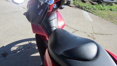

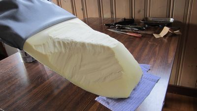

I took my PCX to a local shop to see about getting different shocks, he advised against it. Said I could get different shock mounts welded on, but thought that would void the warranty so didn't do that either. Next I took the seat to an upholstery shop that restores motorcycle seats, they said there wasn't really enough foam to shave off to make much of a difference. What I hoped was that they could cut into the round plastic part of the front underseat and plastic-weld it lower, but they couldn't. So, frustrated, I marked the part of the seat I sit on during long rides, took the cover off and started shaving foam in front of that. I took foam off the top and the sides of the seat with a kitchen knife, then sanded down the harsh edges with 150 grit sandpaper. Then I recovered it. Now I can slide forward when I stop and get both feet on the ground almost flat, and slide back to the comfortable foam part to ride. Works for me.

I always like DIY solutions, they're the cheapest route. Were you able to get the leather stapled back on well enough?
Re: Seat height update
Posted: Thu Nov 01, 2012 5:00 pm
by Indyglow
The cover is pretty smooth, not perfect but good enough.

Bigger pictures.
