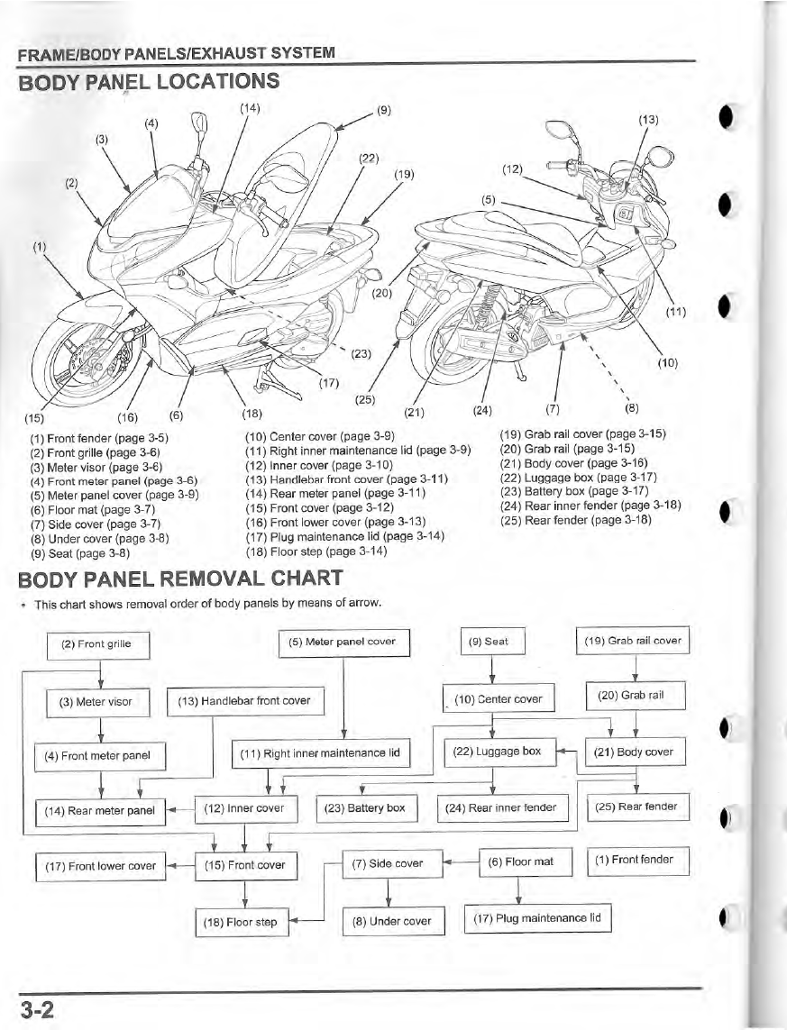

The service manual includes a complete tear-down guide.
What panels are you replacing? There's many ways to get all the panels off, but there's 3 main disassembly courses...
Rear-end: Remove the seat. Remove the rear wing cover. Remove the rear wing. Remove the battery cover. Remove the under-seat bin. Remove the fuel flap. Remove the center cover around where the fuel flap was. Remove the left / right rear panel, along with the taillight (it all comes off in one big U-shaped assembly).
Lower panels: Remove the floor mats. Remove the side lower panels (L and R). Remove the bottom panel.
Front end: Remove the windshield. Remove the panel under the windshield. Remove the meter, meter panel, and handlebar cover. Remove the inner cover. Remove the front cover and headlights.
Complete the 3 above to be able to remove the main floorboards.
Here's the most useful page relevant to what you're trying to do in the manual:
Panel removal chart.png (598.3 KiB) Viewed 22227 times

Thanks for that info, it is helpful. I have the service manual coming, should have it today.
I have to replace basically the entire right side, front-side, lower, rear side. Just have to figure out how to do it. I'm thinkin' it shouldn't be too bad.

Just spent about 5 hrs in the garage swapping out the entire right side, and front left side of my PCX 125. The whole process was pretty complex but went off without a hitch. The service manual was invaluable to get this all done properly. They take you thru the steps including what needs to be removed before you can actually get to the part in question. Also, the trim removal tools I bought for the project were worth their weight in gold, tremendous help in that I didn't break a single tab or hook in the whole process. Everything fit together perfectly. The bike looks good as new. I still cannot believe that these body parts are as inexpensive as they were. I mean you could change the color of you scoot every year, or even mix colors if you like, for $100.
The front-side panels are absolutely the hardest to remove. They require a lot of pre-removal of other panels to get off. Namely, the front grill (panel directly below the meter visor 'windshield'), 3 inner panels (around steering, glove box, aroung the ignition key area), the cover over the fuel fill. Then in Honda's infinite wisdom, the last screw holding the front cover on is buried below the very front of the rear side cover, just above the step.... ARRGH! That required removing my box on the rear, the grab rail cover, the grab rail itself. Then you have to remove the tail light assembly and BOTH rear side panels as a unit. Then, and ONLY then, can you get the front covers off the bike. WHEW!
Once all of that is removed, getting the step and the lower panel below is a piece of cake. So basically I had the entire bike torn down as far as the body panels go, with the exception of the meter assembly and the windshield (meter visor). It all required a lot of patience, the right tools, and to take you time and being careful. There was a lot of jumping back and forth thru pages in the manual to get everything off in the right order.
Hard to believe that you have to remove the tail light just to get the front panel off. I now know what you have to do to get to the engine to service it, and why Honda dealers charge you so much to do it, it's ALL labor.
Anyway, all is good now. Putting it all back together was a snap. Once you do it the first time it's fairly easy, it's just is a lot of steps.

They work great! Sometimes you have to use more than one to work the panel off. Just be careful, study the panel removel illustrations to understand where the hooks and tabs are and pry close to those areas and in the right direction.
