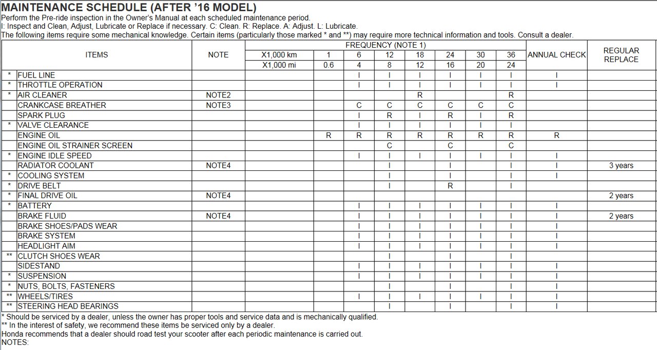

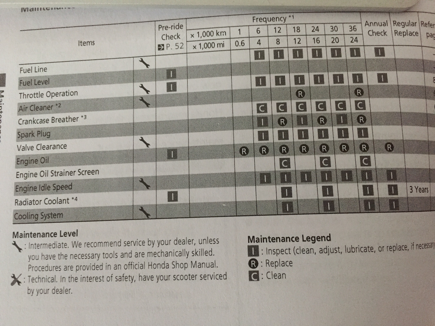

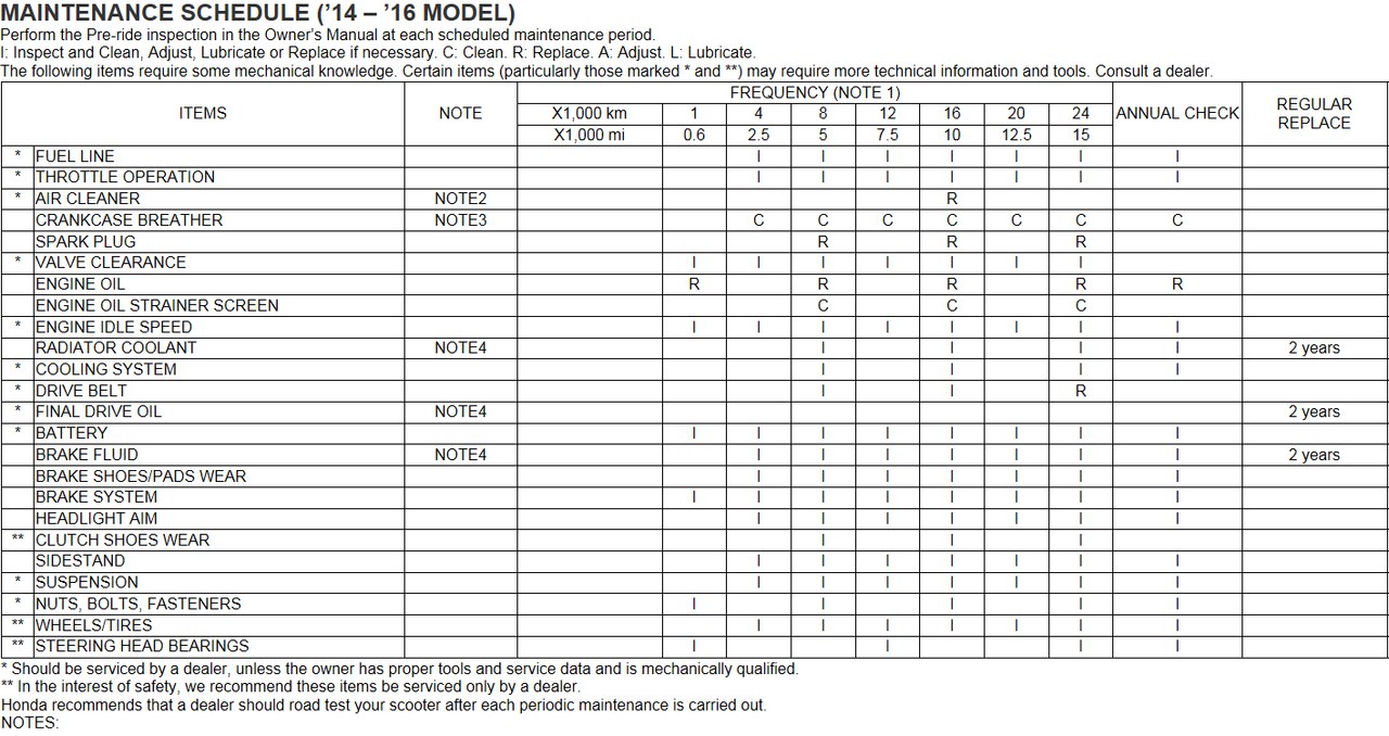

No owners manual with the scooter? Here are two comparitive schedules for service for pre and post '16 models. They were posted on this forum I believe.

I did my first Engine oil change at just over 600 miles. I did my first Final Drive oil change at just over 1000 miles. Final Drive oil should be good for a couple of seasons but I wanted to get fresh oil replaced early for obvious reasons. . .and yes there was some very fine shiny gold colored particles reflecting in the sun from the original factory oil after break-in.
The replacement amount of Engine oil is a whole discussion in itself. For the most part it takes about 800 ml (or about .8 qt) but the SM indicates if you disassemble the engine or clean the strainer screen it should take a quart. I did that and ended up having to remove some oil because it was overfilled and I tried to get out every drop of oil I could when I drained it. Some oil hides in cavities and you never get it all out. So be careful when you drain and refill your Engine oil and just fill it up to the top line of the dipstick (when not screwed in) IAW the procedure in the manual (you need to run the engine for a few minutes to warm it up first). Measure it several times to be sure.
My 2017 PCX was made in Vietnam and has the U.S. Owners Manual stating that the valve clearance needs to be done at 600 and 2,500 miles and then every 2,500 miles after that. The Service Manual I got from the dealer which was printed for 2013 - 2015 models had been re-identified in inventories with new stickers making it applicable up through 2017 and said the same.
I haven't done a valve clearance check on it yet and don't plan to until 4,000 miles. The manual that comes with the newer PCX models in the U.K. lists the first valve clearance check to be done at 4,000 miles. Why there is a difference between manuals on one side of the pond and the other side of the pond I don't know. That being said my PCX runs fine and valve noise is consistent. . .no changes there. . .no quieter. . .no noisier. Performance has only improved as it's now breaking in and I just turned 1,300 miles on it the other day. I do recommend checking the tire pressure daily. . .just give the tires a squeeze (like on a bicycle) to see if they seem OK. At least once a month put a tire gauge on them and top off the pressure. . .don't be surprised if they drop a pound or two over a month. Also ambient temperature and seasonal changes effect the tire pressure. Always check them before you ride when they are cold.
