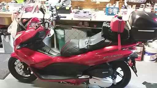

Recently, there was a post in the "PCX Deal of the Day"
It showed a top box mounted on the back of the seat.
I was very interested in the mounting, and I contacted the seller of the scooter.
I will be buying the top box next month and have extra storage on my rides.
He was VERY helpful and provided the following information.
"I used a carpet floor mat and mounted it to the bottom of the trunk mount plate to protect the seat. Then I mounted two u-brackets under the seat to keep the strap from sliding back when accelerating or stopping. Then I used a duffle bag shoulder strap and cut the pad in the middle and mounted each end on each side of the mounting plate using six machine screws. This method works really well for I can just undo the strap and remove the trunk with no damage to the seat. Hope this helps."
Here is the link to the top box:
https://www.walmart.com/ip/Yescom-30L-M ... /678308450
He also sent the following photos to show how it is set up. This is his PCX, not mine, but I look forward to having the extra storage next month!!

So all these pics and no pic of it mounted on bike?
Please post one, nice mod.....

Jge64 wrote:So all these pics and no pic of it mounted on bike?
I added one of the photos from his craigslist post to the original post here. . . Look Up!! LOL!!!

Interesting Mod, but what needs to be done to take it off in order to lift the seat and access the under-seat storage compartment?

kramnala58 wrote:Interesting Mod, but what needs to be done to take it off in order to lift the seat and access the under-seat storage compartment?
Looking at the craigslist post, the box clears the handlebars when the seat is in the upright position.
I will give it a try next month (payday) and post photos then.

That is my bike. Here is a picture with the seat open. One thing I needed to add. The strap goes completely around the truck mounting plate (between the trunk and the top of the mounting plate). The screws hold the duffle bag pad and strap in place.
I haven't noticed any stress on the hinge, course I don't have twenty pounds of gear in it when I lift the seat.
