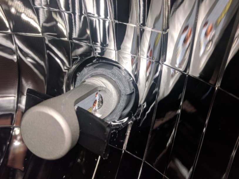

I retrofitted the LED headlight bulbs onto my scoot, but it wasn't a plug and play. I used my 3D printer to print a OEM type lock on mechanism to use with the LED bulbs. The LED bulbs that I used mimicked the H4 filament layout, making my high beam useless. I still haven't found a plug and play LED headlight bulb. I working on a better solution, ei looking for better designed LED bulbs. I recommend LED bulbs with Philips lumileds SMD LEDs. They provide the smallest bright LED chip that can more accurately mimic the OEM bulbs filament position. I'll add some pics, in an hour or so.

The led lights that i'm using have four led chips, per side of each LED "bulb", for the Low beam and another set for the High beam. Because of it the Headlights are too bright now. I'm looking for LED headlight "bulbs" that have 3 Philips Lumileds per side of the LED "bulb". The led lights i'm using aren't an official Philips product and might not even have authentic Philips LED chips. On official Philips H4 LED lights, they use 3 led chips per side for Low beam and a separate set for high beam.
Here is an example of the Philips H4 LED lights.
https://www.hidconcept.com/collections/ ... RrEALw_wcB
Here is a picture of the final product.
Gil

I added the locking clip to thingiverse.com. It's for an LED bulb with an outside diameter of 18 mm.
