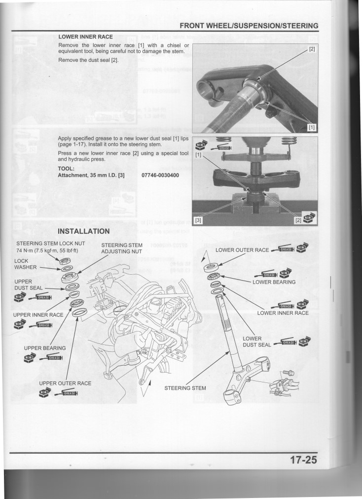

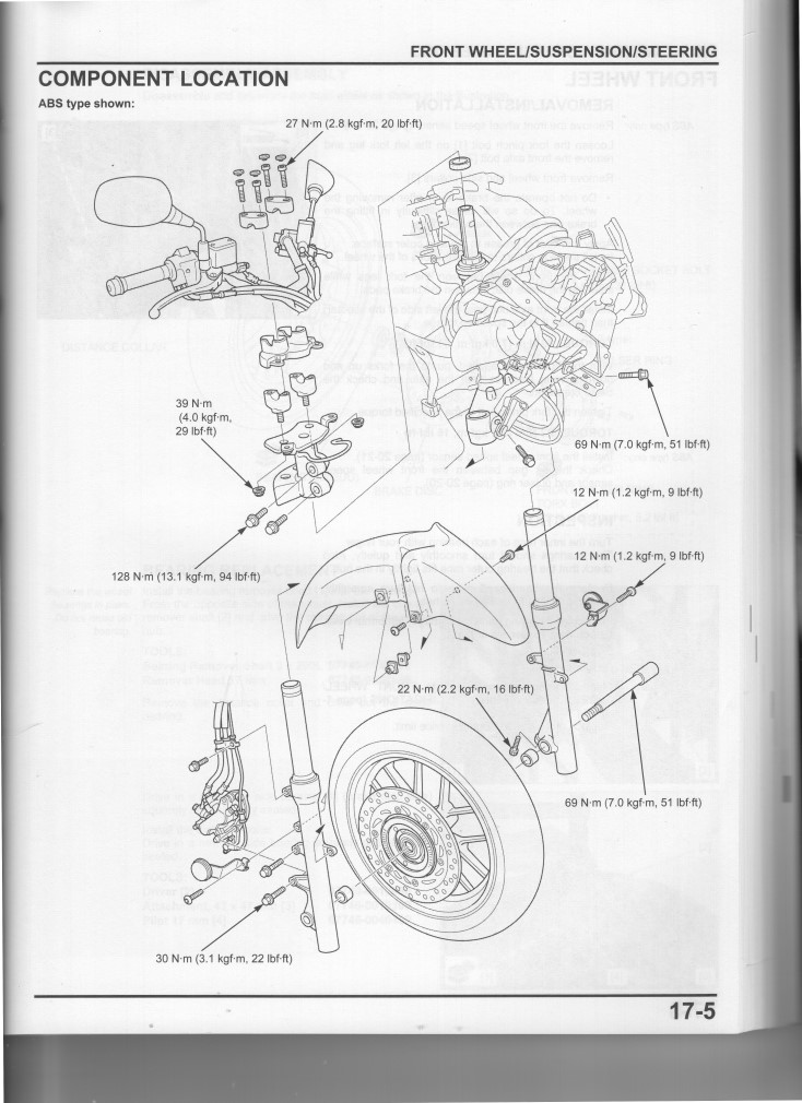

The headset bearing needed adjustment, anyone have the torque settings for the locknut and the bolts?
Re: headset adjustment
Posted: Sat Dec 16, 2017 4:47 pm
by GeorgeSK
Steering Stem Locknut is 74 N-m or 55 ft-lb.
Posted: Sat Dec 16, 2017 5:15 pm
by knick620
Thanks GeorgeSK, thats tomorrows job sorted.

The service manual is sometimes online "somewhere" for this obsolete Honda product.
Posted: Tue Dec 19, 2017 12:15 pm
by aguim
First, removing the stem locknut (55lbs torque) requires a very deep special socket, 32mm octogonal,
unless there's an equivalent replacement available.
Under that is the adjuster nut itself (initially torqued 15 lbs, then loosened, then finally torqued 2lbs,
no more). Again, a costly special tool apparatus is recommended -but not really needed (I tightened.
it using an old, short Yamaha shock spanner, to 'around' 2 lbs (and it has worked just fine for the
last 13,000km).
I found most of the front end bolts/nuts to be grossly overtightened, not loose in any way. Used
anti-seize everywhere and tightened them more reasonably

I had enough info to loosen the nuts and adjust the bearing (I used a 32mm crowfoot spanner with a torque wrench on a bar), I didn't have the torque settings, but a pm and the pages from the manual were more than enough, thanks for confirming the detail though.
The job is complete and it has sorted out the problem.
