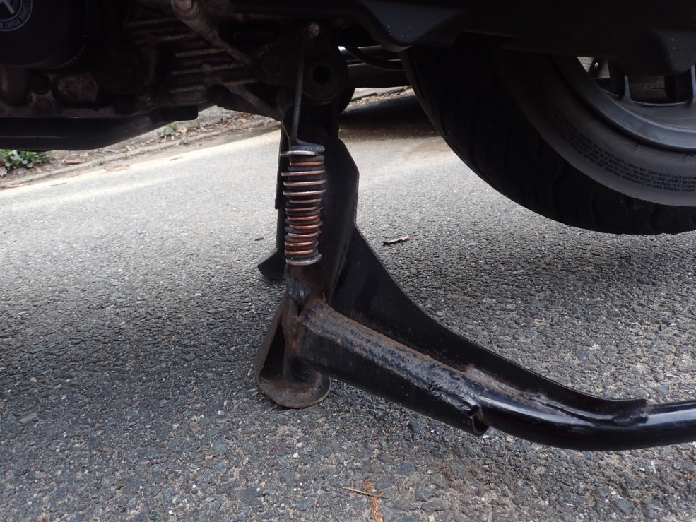

My stand was not coming up on its own, so I knew it was crapped up. It seemed like a quite doable job, so off I went. I tried the coins in the spring trick:
TG-4 -P4130068.jpg (227.6 KiB) Viewed 59818 times
It sorta worked, but I still needed a 3# phillips screwdriver at the end.

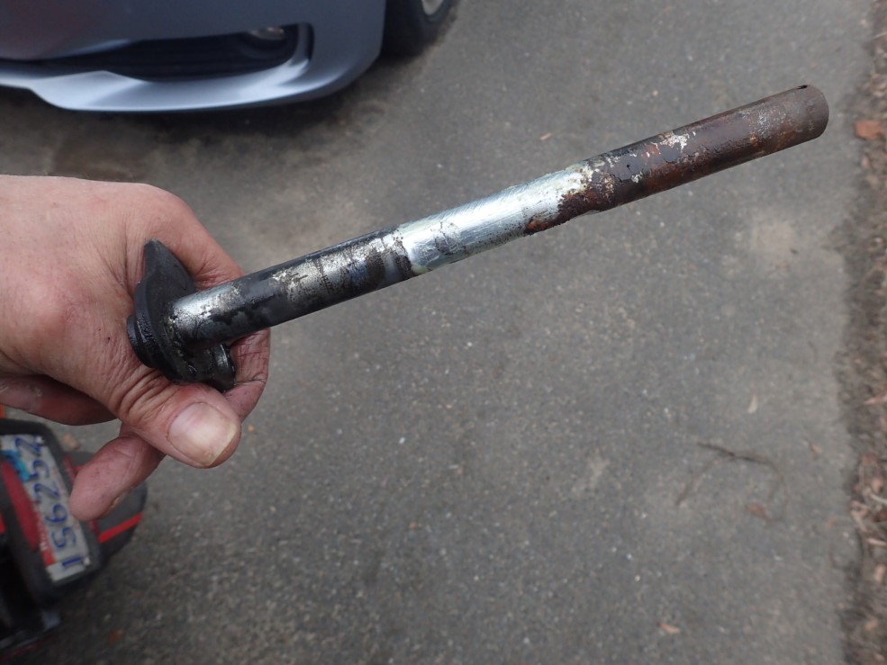

The bolt is a 12 mm - it came out easily, as did the cotter pin. The shaft, however,was not interested in budging. After a few taps to no avail, I decided to go down cellar and see if I could cobble together some sort of drift pin thing. I found a bit of 5/8" mild steel (a curtain rod offcut). I put it in my wood lathe at ~400 rpm, got out my flat file, and had at it. I formed a locator stub about 10 mm diameter. It took at least 25 minutes. I gave the shaft a spray of silicon lube in hopes that it might soak in while I futzed with drift-making.
TG-4 -P4130070.jpg (282.72 KiB) Viewed 59818 times
This let me tap out the shaft, and this is how lovely it wasn't:

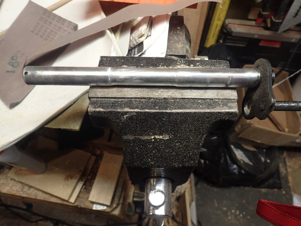

Down to the vise and some time with 180, then 320 paper. I got it sort of shiny:
TG-4 -P4130071.jpg (151.87 KiB) Viewed 59818 times

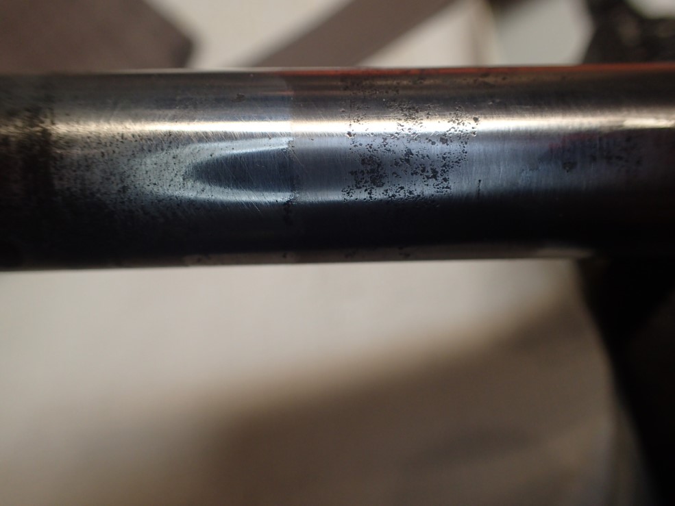

I next tried to use a buffing wheel with some alumina buffing compound. I really can't do much about the pitting:
TG-4 -P4130073.jpg (77.05 KiB) Viewed 59818 times

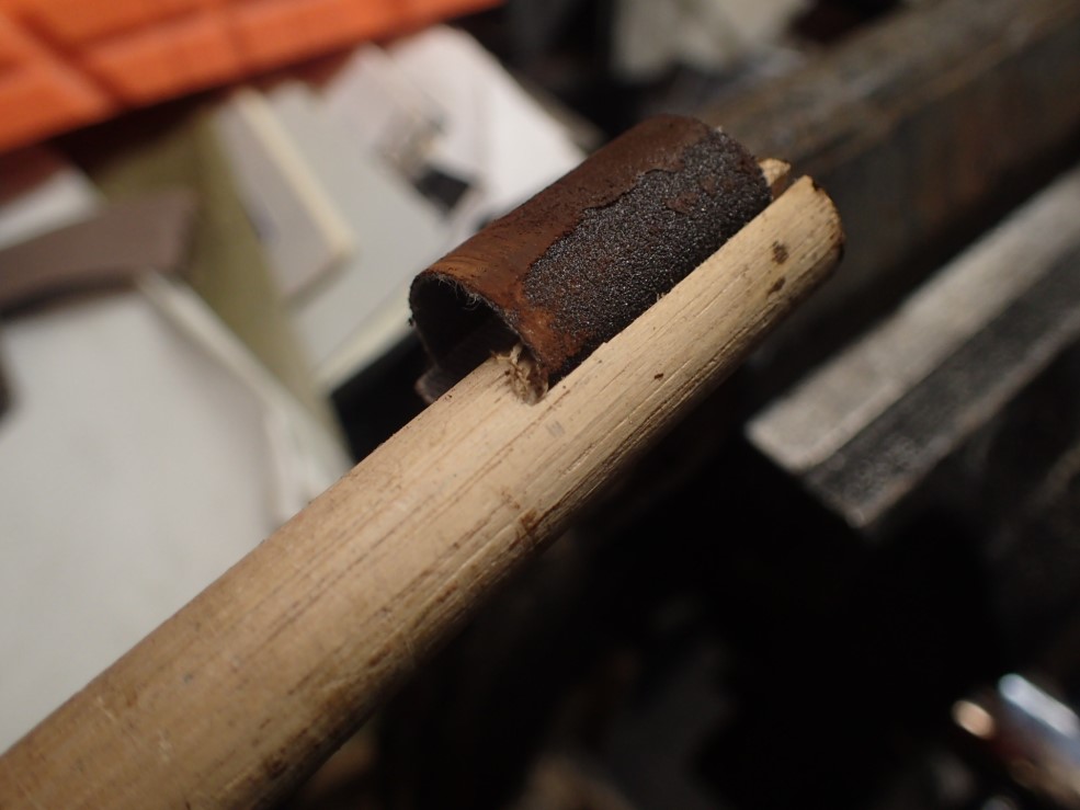

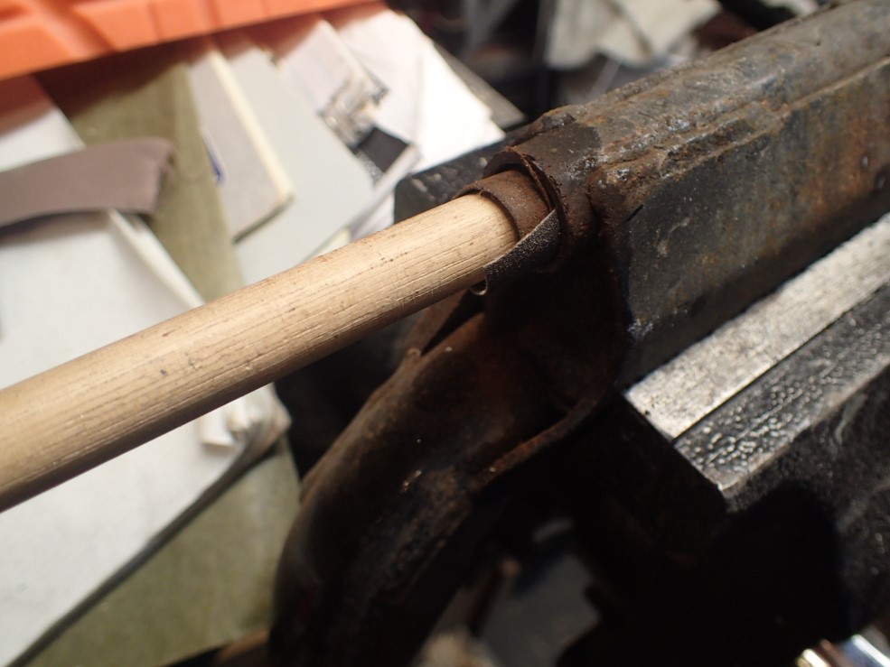

I next went after the stand itself. I took a 3/8" dowel, put a slice in the end, and chucked it into a cordless drill. I added a bit of 180 paper, and let 'er spin.:
TG-4 -P4130074.jpg (84.08 KiB) Viewed 59818 times
TG-4 -P4130075.jpg (107.67 KiB) Viewed 59818 times
That seemed to be about all I could do. I sprayed the shaft and the inside of the stand with molybdenum dry lube (hoping to prevent further corrosion), then slathered the shaft with water-resistant axle grease. Everything slid together just fine. After a number of attempts, I got the spring back on (a dab of grease on the shaft of the screwdriver proved most helpful).

The coins trick was of limited success They did not fully expand the spring to where I could just take it off. I got it off with a small bit of prying, so it did ease spring removal.
I needed more expansion for spring installation. My first try, I lost about half the coins since I had to pull the spring more "open". After that, it was the classic "put the notch of a phillips driver tip over the hook, lever it up, and slide the spring down the shaft". I repeat - a dab of grease on the shaft helped a lot.
