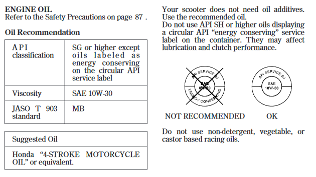

"What oil should I use in my PCX?" 10w30. Synthetic. The only caveat the manual mentions is to make sure it doesn't say "Energy Conserving."

Here's the owner's manual page on oil weights:

Now, all of this is further complicated by operational temperature. In Thailand, it's hot. In Canada, it's cold. The same 10w30 operating in a PCX in the summer in Thailand will be at a higher operational temperature than the 10w30 in a PCX in Canada in the winter. The bottom line is, oil gets thinner when it runs hotter, and therefore higher weights are more suitable for hotter climates. Here's the chart in the owner's manual on oil weights:
