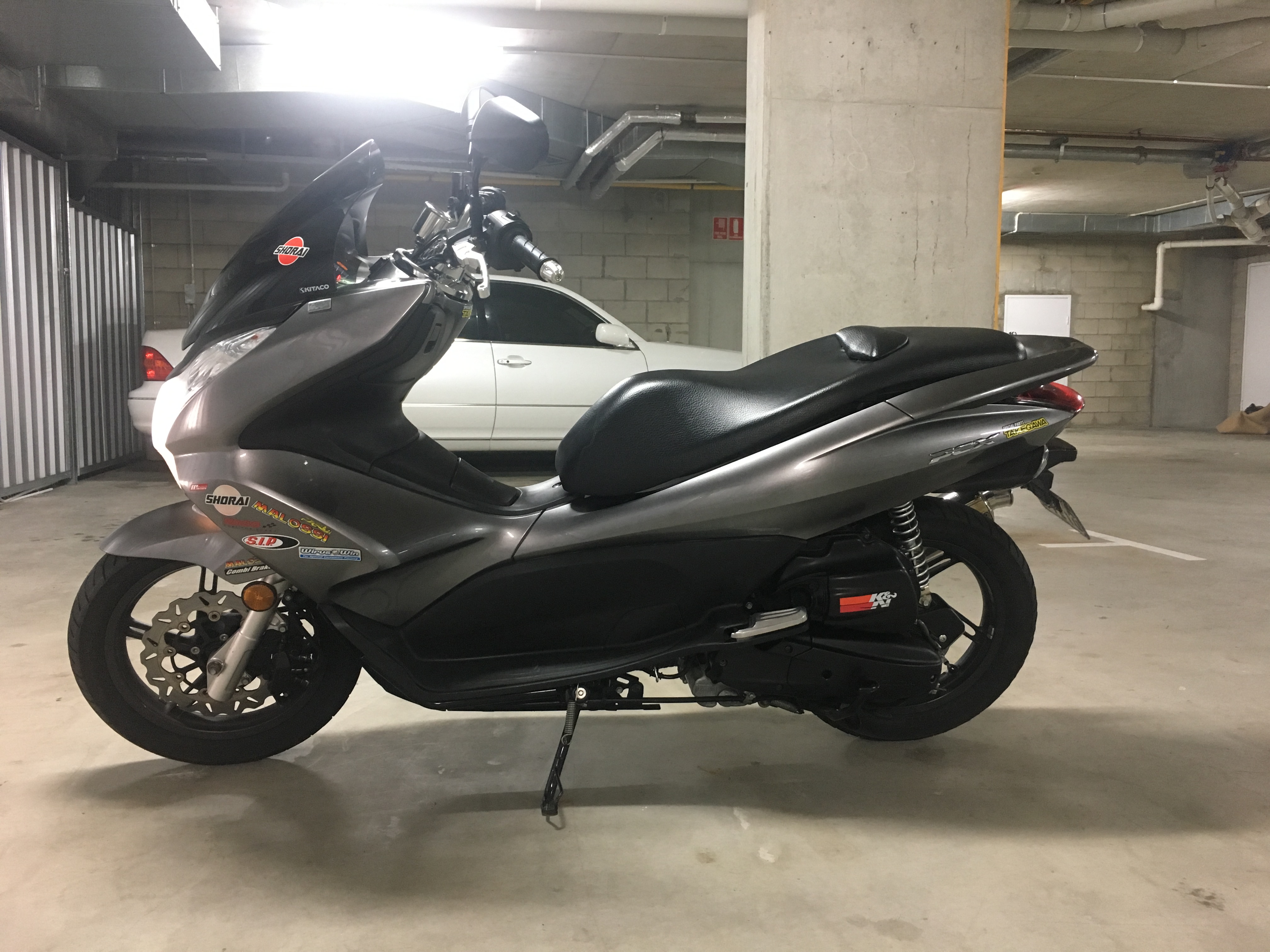

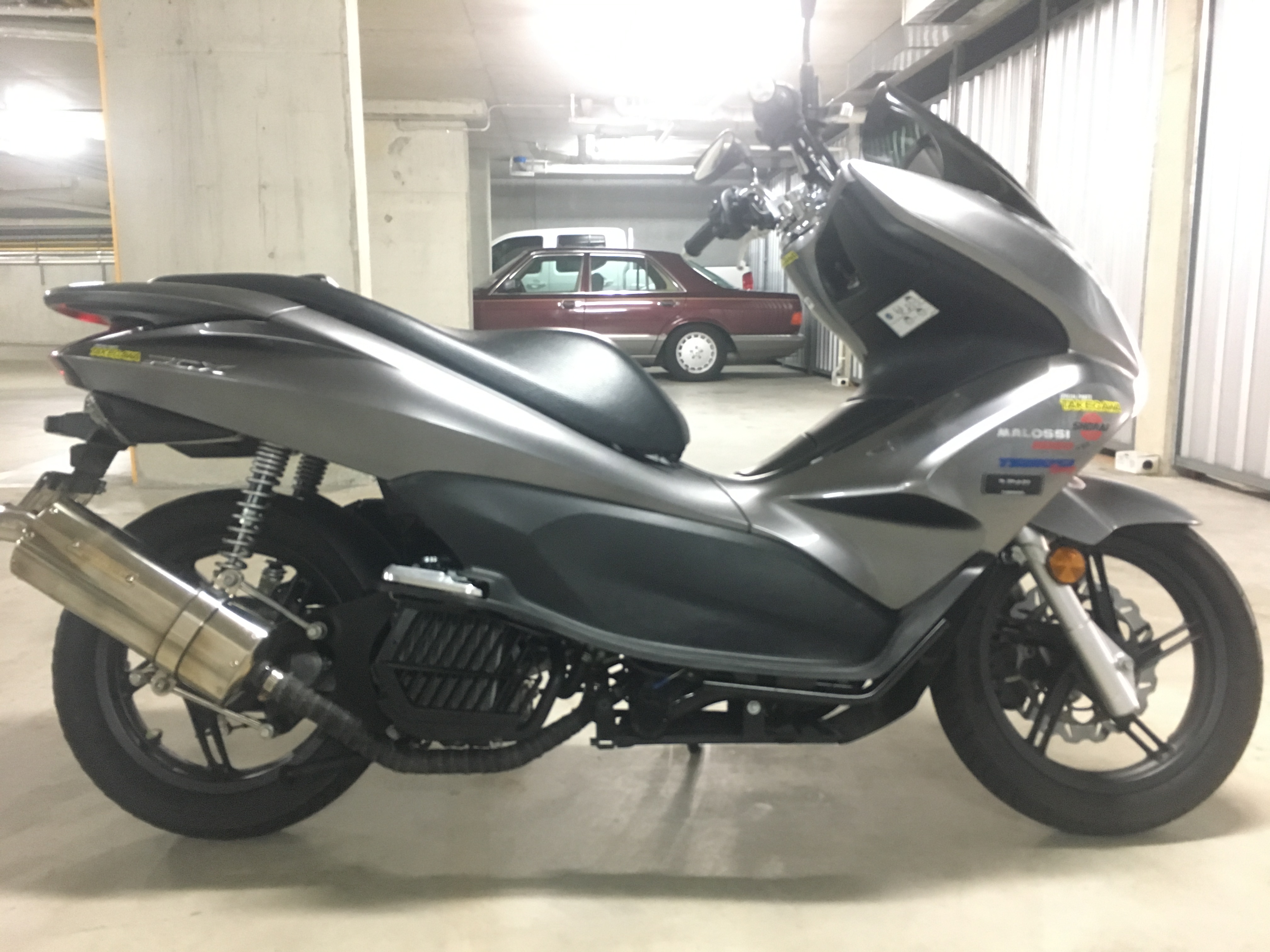

Exhaust wrap done today. Did it for visual effect. Did make it bit quieter and the muffler has bit more base..

Here is another one

And transmition cover blacked out in plasti dip. I like it because it's not permanent.
