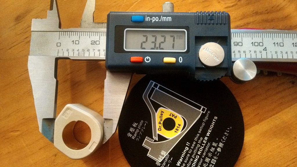

Hey Ed, curious why you measured the sliders at these two points and not where the ramp plate makes contact?
Mine arrived today and when I measure where the ramp plate makes contact I get the same 23.3mm as the stock rollers.

Re: Tuning the Forza 300 CVT
A good question but one you'll be able to answer for your self soon enough.
The slider never actually makes contact at the point opposite the flat where you measured.
The installation drawing accurately depicts this.
all lifting contact occurs on the front half of the slider so there isn't actually a physical point to measure the slider as there is with a roller.
What I did was install rollers of a known diameter and measure the assembled thickness of the variator with thrust plate then compare that to a measurement obtained with sliders installed. What I determined was that sliders are ~.8mm - 1mm smaller than MOST 23 x18 rollers. The point where I measured was the closest measurement to index sliders to rollers.
Test this for your self for confirmation.
I dug up some old slider to help show this....
these were sliders I made by swapping out 24g cores from Honda rollers.
They have well over 20,000 miles on them.
