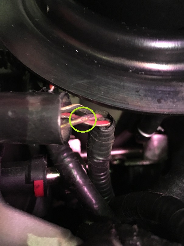

Techno maybe I didn't fully understand you. I wish we all had diagnostic software for our scoots. Just last week I experienced engine missing at a specific lower RPM in every gear on the Buell. All kinds of possibilities raced my mind. Fuel pump, spark plugs, ignition coil and the dreaded electrical issue. Plugged the laptop to the bike and ran diagnostics. An error code reported (throttle position sensor short to ground) WHAT! Straight to the sensor on the throttle body tracing the wires back to the harness I found a chaffed wire scratching on the fuel tank. 30 minutes, a piece of electrical tape and a little repositioning of the line and ran like a bat out hell again.
Without this ability I never would have found such an issue. Down for the season or HUGE service charges from Harley would have been my options. I wish at the very least we all had error code plug in dongles for PCX.
