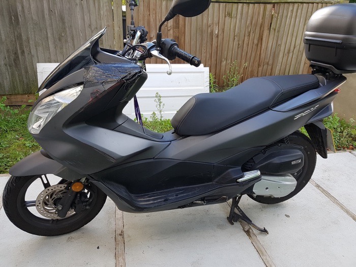

Hi everyone, my wife had a small slip last week with our PCX and the left side cover has now a small hole. Does anyone knows if it's fine to tape it or cover it somehow? Or there is any issue with riding like this? See the picture below.

Small slip?? Hmmm... I don't think I would drive around like that for long, but then there are some who use duct tape for everything automotive, so who knows? You do know that to get that panel off you will have to start from the back and take every panel off on that side, don't you? Well, you aren't the only one to ever have damage to that particular panel. I have replaced that particular panel twice, so just order the replacement panels and study the how-to. It will be a good learning process.

You should be fine to ride like that. Consider buying new panels, I thought that they were quite cheap.

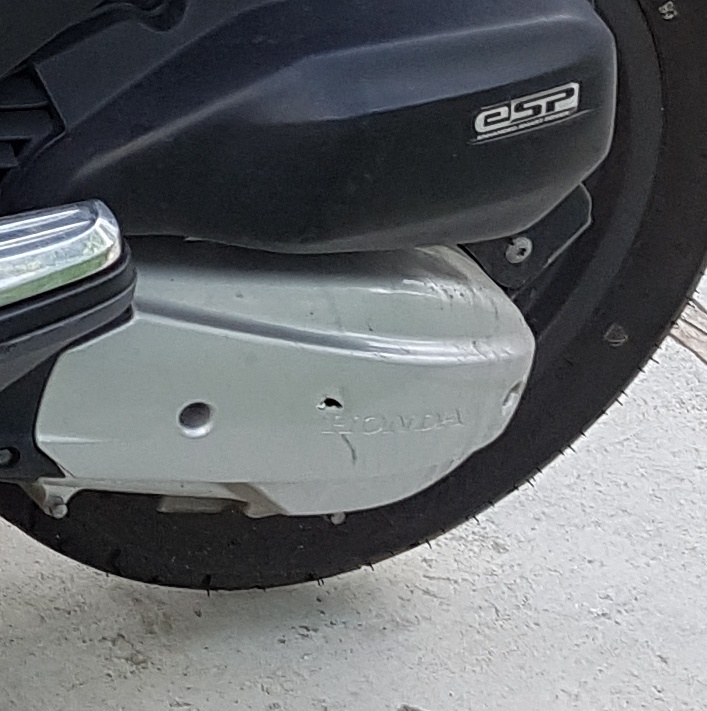

Now, regarding the hole I'm talking about, is not in the front panel, but rather in the crank cover at the back. See zoomed picture. I haven't rode the bike since the accident and don't have time now to bring to the mechanic.

WOW! that's a HOLE in the CVT cover. Fortunately not in a place that matters. This is not a sealed compartment, open air and can fill with water in a puddle anyway... you're good.

Important to keep that covered as you don't want any crap getting in there! I believe that is part COVER, L. SIDE, 11341-KWN-780, about $90. $12 shipping (air-freight 2 week delivery)
http://www.partzilla.com/parts/search/H ... parts.html
Cheapest option, water-proof industrial glue and some plastic to cover it.

I've repaired holes similar to that with some high temp epoxy like JB Weld.
Just clean both sides with alcohol (rubbing not drinking) and put a couple of layers on it.
It will hold you until your new part arrives.
Then, keep the repaired one in case it ever happens again.

JB Weld can fix anything. Just purchase some and fix the hole. Then buy some silver spray paint, clean the part and then repaint it. It will be fine until you decide whether you want to replace it or not.

TBH. Chewing gum will do the job. The whole think is vented.
