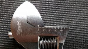

If you're buying an adjustable spanner, make sure you get a metric one...

Post by davenowherejones »
gn2 wrote:If you're buying an adjustable spanner, make sure you get a metric one...
Here you go.

Re: Valve adjustment access.
Post by erisaman »
Here you go.
Thank you GN2 - and thanks to davenowherejones for the pic - am so smiling here :) - your username has always struck a chord with me as I'm from Wales and my name is ...... (ain't many of us left now - they've all gone 'nowhere').
