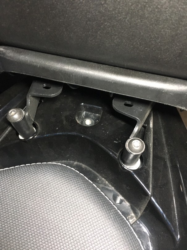

How can I remove this and where can I get the correct replacement screw? I've been going at it with an extractor bit set but have made very little progress. Not sure how the screw stripped in the first place. I'm assuming there must be some serious threadlocker on the screw.

I've managed to strip this middle screw here under the grab rail cover.

Are you sure its stripped ( threads gone) as opposed to rounded (turning surface gone)?
It looks like the latter. Youll need an extractor or drill it out. I'd suggest finding a friendly small garage to sort.

It is very easy to cross-thread that particular bolt. I did that once and I had a heck of a time getting it out. I eventually used a vise grip on that tiny head and was able to turn it a little at a time. What a nightmare. Good luck.

Hard to tell by that picture but it looks like the crown of the screw is ripped off. Try a small easy out, or like Mel says use small vise grip and hope you get a bite on it. You can also use a small sharp punch and work it out little by little with circular taps with a small hammer. Worst comes to worse just drill out the plastic around the screw and lift off the panel. Once the panel is off then you can grab it with the pliers and work it out. Replace panel without that screw or use a wide washer.

Centerpunch, drill, and easy-out will work. Mel's extractor set might as well - I have one but haven't put it to the test. Same deal though - DO centerpuch the middle before trying any of this "drill it out" stuff. File or grind smooth with a dremel if necessary.

If vice grips don't work, is there enough room for a Dremel to cut a groove across the head for a blade screwdriver ?I've managed to strip this middle screw here under the grab rail cover.![]()
To best use an extractor, get a set of "left handed drill bits" which work like normal bits, but in the reverse direction. About 50% of the time they are used to drill an extractor hole in a bolt/ screw, their reverse bite will actually catch and turn out the bolt without even needing to use the extractor. Hope this happens, because the problem with an extractor is that if they snap off flush, their are just awful to get out.
Don't try removing any more fasteners until you first get the correct size hex wrench, Phillips or blade screwdriver that matches it.

So after trying a dremel and finding out that i couldn't fit the dremel wheel in due to the recessed area and managed to bang up the plastic a bit with the wheel. I began cursing then I ordered the PZ-55 pliers. These didn't work either and I was about to give up, however I went out and bought a can of Pb Blaster and tried again using literally all of my strength and two hands to grab the bolt with the screw extracting pliers. CRACK! The sound of freedom! i finally managed to get the damn thing.
Thank you for the oddball suggestion. Will definitely be being more careful from now on.
