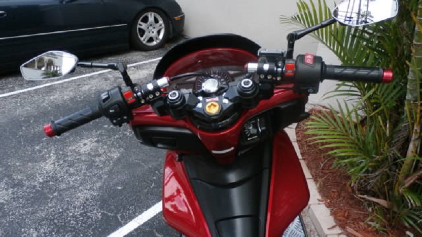

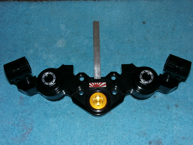

I did this a while back bikerz accessories. And used a Yamaha R1 caliper plug to dress up the center nut. The long bar in center was added, cut down to fit a clock and painted black and later replaced with a Koso electrical RPM gauge. I also cut down the adjustable height clamps and modded the windscreen to allow a more forward and lower (2" lower and 1.5" further forward than gthe stock chrome handlebar) to put a little more weight on the front wheel and a less 'sit up and beg' riding position. It feels roomier now and the handling benefitted slightly into the bargain.

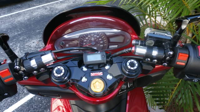

Heres the one with the Koso RPM gauge installed instead of the clock
