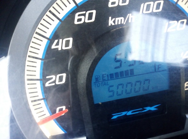

When my PCX reached 50,000 kms, I decided to use Fully synthetic coupled with the gear oil, for the first time.
And what a difference it made, the engine revs smoother and more quiet. I wished I started using Fully Synth sooner.
Although at 50,000 odo, I also changed the entire variator set , the belt, and clutch pads, so it could also be the reason for the overall smoothness I am feeling.
