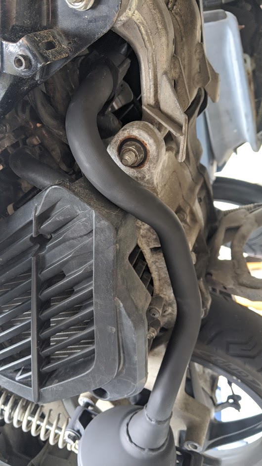

So, I bought an 2019 OEM exhaust and it almost fits. The issue is that two of the swingarm bolts don't line up properly and the only one that does line up needs a spacer. Will install in within a month and report back.

I followed your guys suggestion and bought an aftermarket exhaust. It is about as quiet as the OEM exhaust and has a bit more power. They claim one more HP, but dyno says eh. There is some performance increase in the Highway, but nothing crazy. I has no catalytic converter and that's a bummer. I would of preferred that it had a catalytic converter like some aftermarket converters do, but o wheal. Other noticeable effects from the muffler is a bit more vibration of the frame at some engine RPMs.

As for the weight it feels about the same, maybe lighter. Maybe since it's a two piece exhaust, it allows some flex. I will check all the bolts to make sure that they are properly tighten. Next time I remove it I will use a scale to compare the weight of each.
Maybe you could mount rubber bushings between muffler and swing arm to eliminate vibration?
