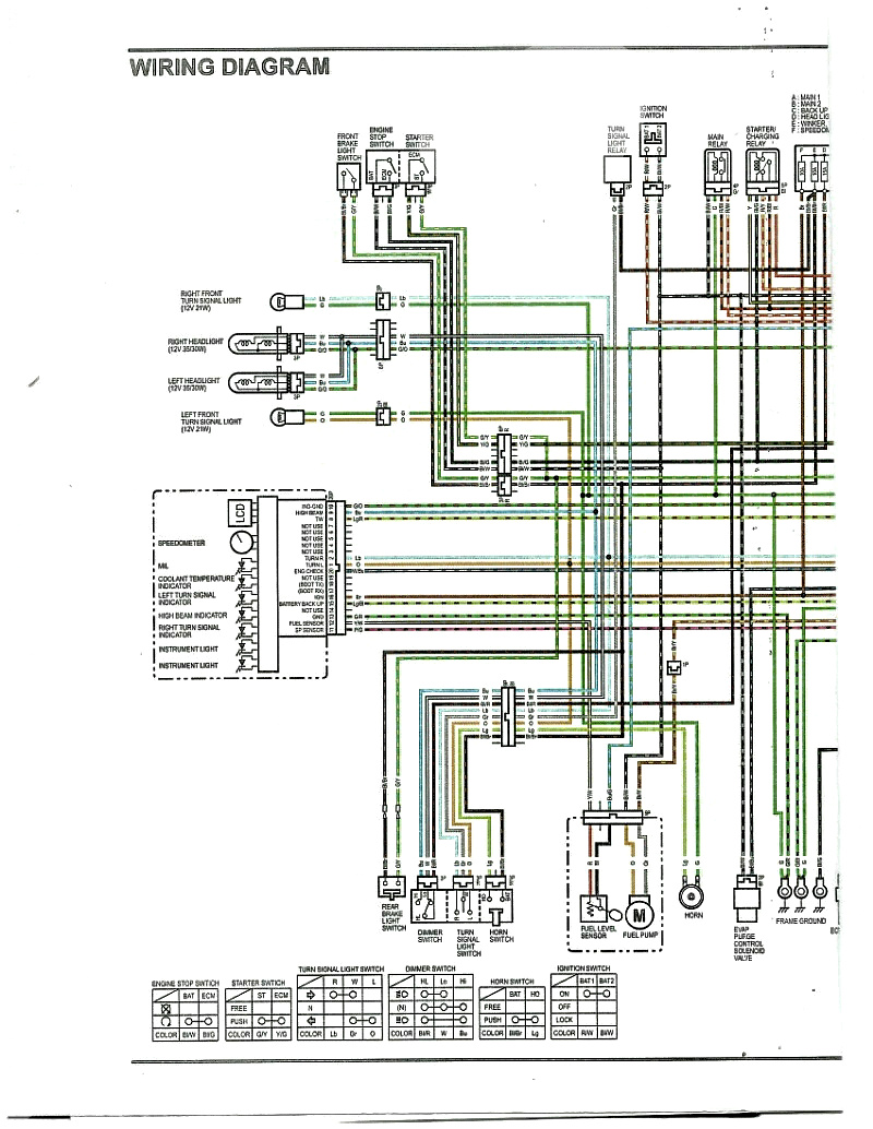

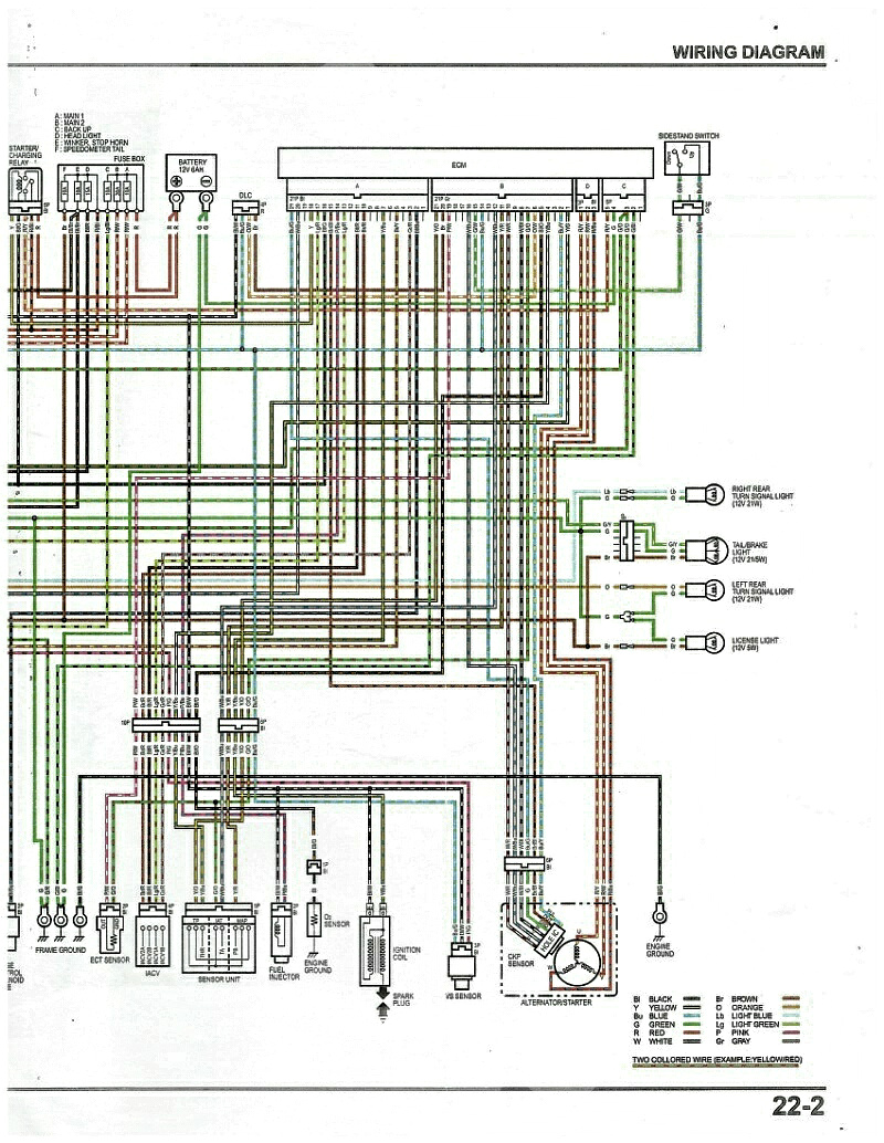

Mel46 - That look like my next move - the main 30a fuse blows right after I key on the ignition. I was unable to get a manual when I purchased the unit, so hopefully I can find some diagrams.
High Contrast Front.jpg (306.56 KiB) Viewed 2525 times
High Contrast back.jpg (408.67 KiB) Viewed 2525 times
Hope this helps.
