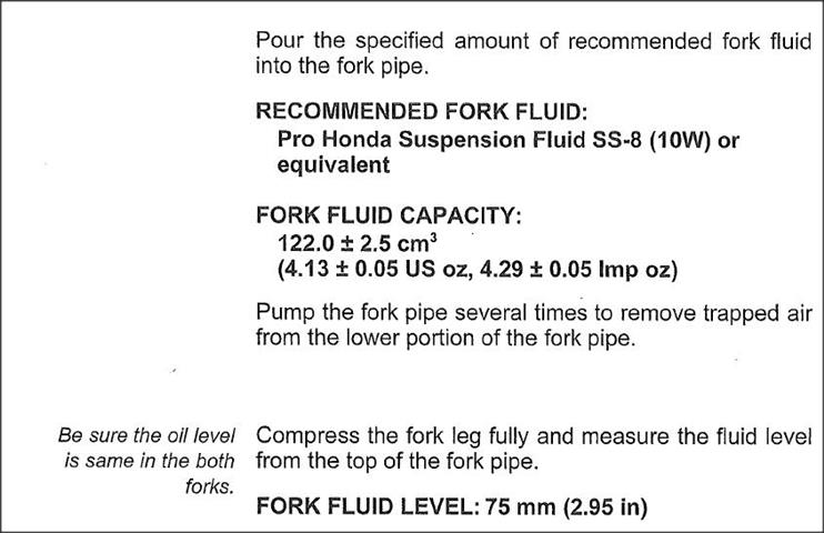

This is from the PCX 150 service manual:
Snap 2020-10-15 at 09.18.03 (Small).jpg (49.28 KiB) Viewed 26050 times

Limey wrote:This is from the PCX 150 service manual:
Nice.

Re: Fork Oil Level?
Post by Oyabun »
Yup, use fluid level rather than the amount.

Re: Fork Oil Level?
Post by sansomite »
Thank you for all your responses!
TheDoors & You You - That would be the ideal solution but unfortunately both my forks have leaked so that writes off this method, at least for this time.
Limey - Thank you for the screenshot! Reading around most manufacturers try to stick to around 100mm+/-25mm from the top. So 75mm probably is right. I wonder if they used the same forks on the 150 as the 125?
I think oil level rather than quantity is the way to go.

Post by sansomite »
FYI - After a little research with the fork part numbers it appears that Honda did infact use the same forks on both their 125cc and 150cc PCX.
SO... Thank you Limey, looks like 75mm is the correct level measurement.
