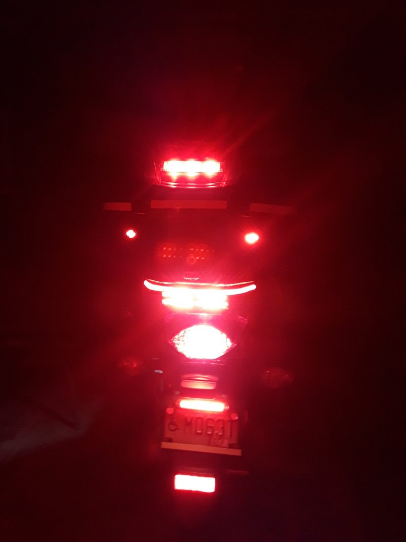

Not sure he can change to led. I bought a led bulb for my tail light but then strange thins started to happen, such as the brake light staying on after I released the bike lever. I put the regular bulb back in and all was well, so now I have extra led lights around the regular light. All works well now.
New Tail lights.jpg (47.43 KiB) Viewed 2001 times

Mel46 wrote: Thu Feb 18, 2021 8:20 am Not sure he can change to led. I bought a led bulb for my tail light but then strange thins started to happen, such as the brake light staying on after I released the bike lever. I put the regular bulb back in and all was well, so now I have extra led lights around the regular light. All works well now.
