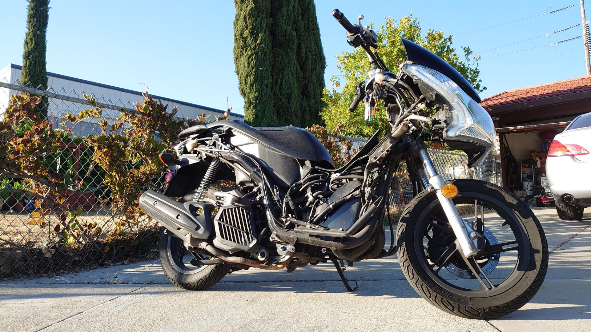

PS. Before I forget, this is all for the purpose of being a reliable donor for a Honda Ruckus swap. So the PCX its in one piece for now (mostly):
2013 Honda PCX150 + 2009 Honda Ruckus
PCX Swap coming soon...
