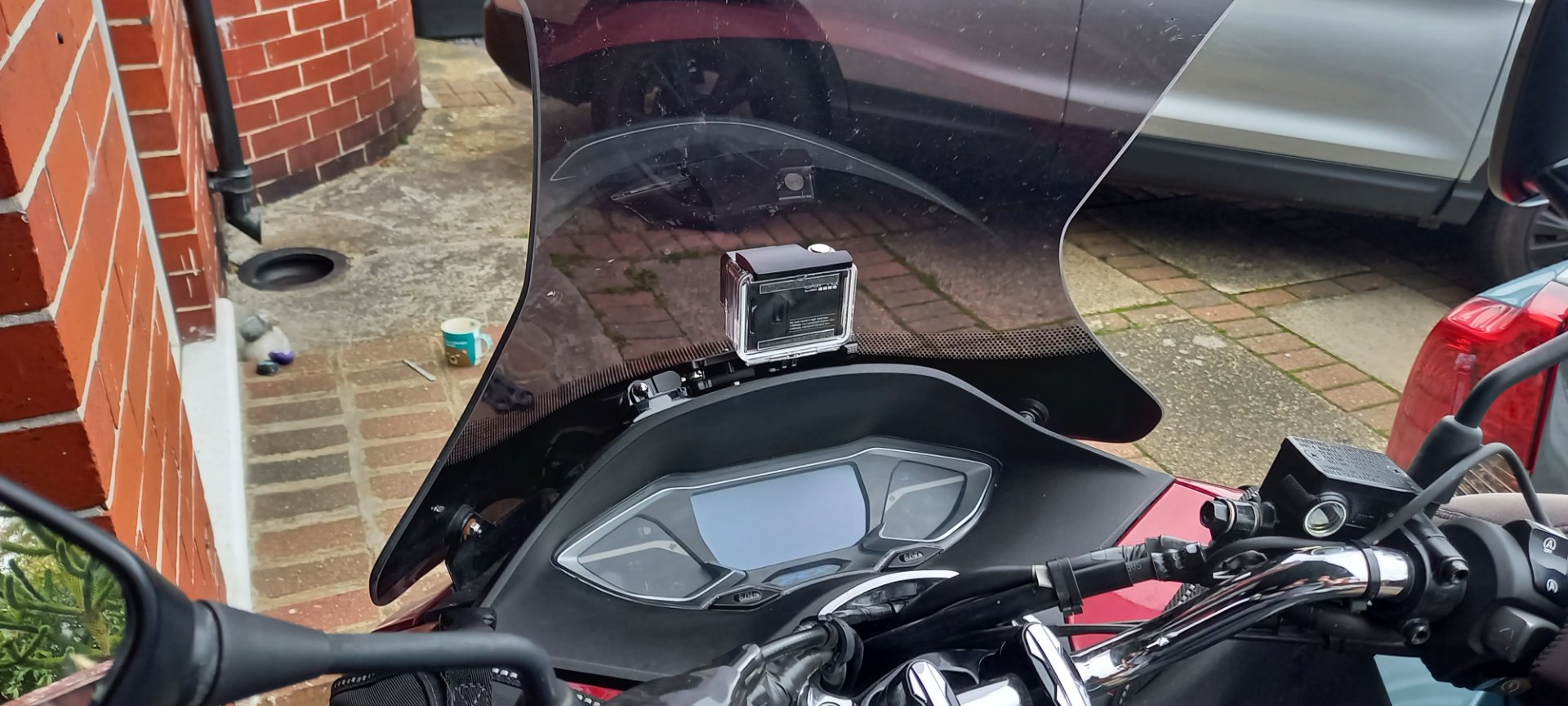

Hi all. Decided im going to hard wire a gopro on the pcx 2022 125. I've bought a USB c to normal USB adaptor so can use the switched power supply in the glove box. Issue im having is getting the wire out off the glove box to the camera as the glove box is a good tight fit when closed. Any one have any good ideas on best way to do it or already done it. Dont mind cutting the glovebox but would like to keep it water proof to some degree

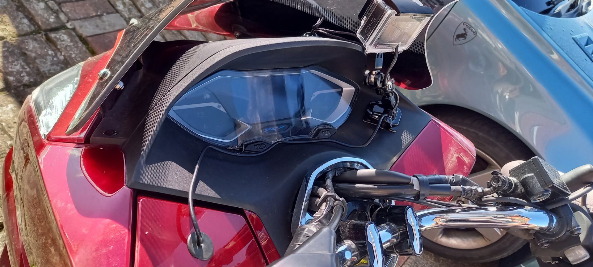

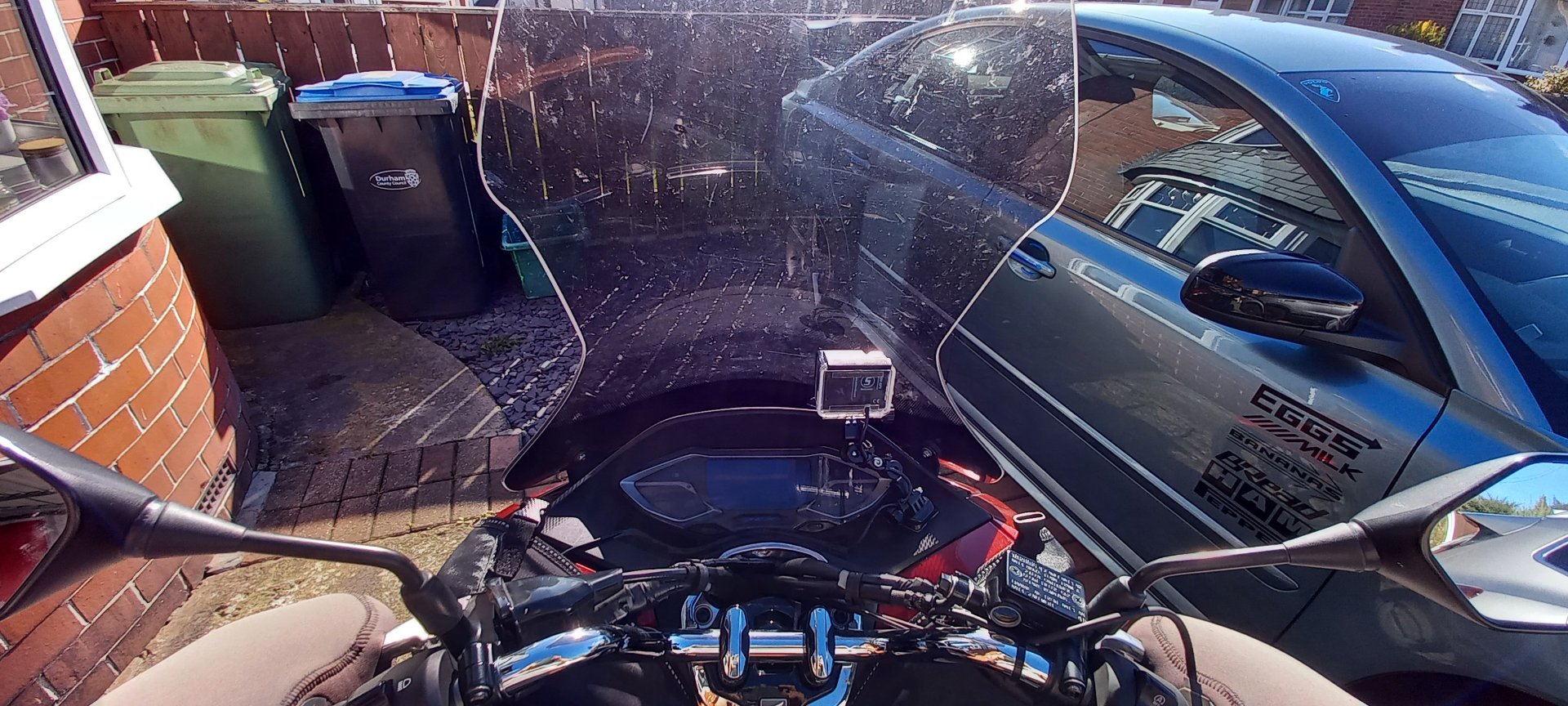

Did a test ride using gopro battery and it was catching the screen and dash surround so moved it. Its now mounted and I drilled hole into top off glove box cover and used a cable grommet to keep it waterproof and prevent rubbing. Works well as can still open and close the glove box
