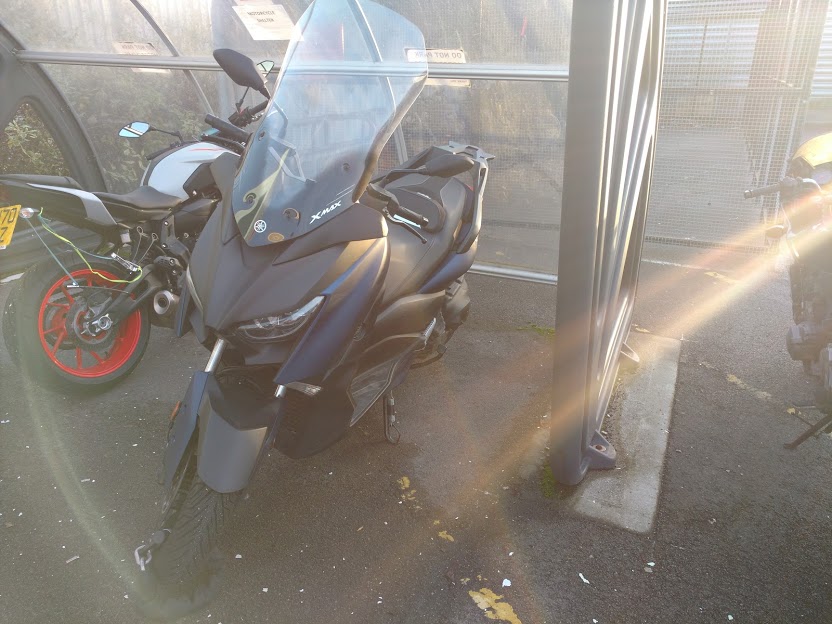

Any pics of your XMax 400???

As requested, the bike in its home away from home, the bike shelter at work. Neighbouring bike is a colleague's MT-07. He just downsized from an R1 because he too felt like something a little slower/less terryfying. It's very clean because, apart from anything else, he doesn't ride in the rain!
The body is identical on all the Xmaxes, even the 125, same frame, same tank size. Dashes are different though, the 400 has different dials and trip/info display (icy blue rather than a plain LCD, looks rather better IMHO). Oh, and the exhaust can is huge- someone on maxi-muppets reckoned he trimmed 8kg off with a Leo Vince one…!!
Tyre widths are 120 on the front, same as the 300, and 150 on the back, 10mm wider, though the rear wheel is 13in rather than 14. The commute route is an excellent test of the ride and handling, as it is mostly on the M27 motorway, currently in the midst of major works to turn it into a so-called 'smart motorway' (an extremely dumb idea involving four lanes of traffic, no hard shoulders and sporadic refuges for breakdowns- these things have caused multiple fatal incidents, but still they build them. A few days back a guy with a puncture had to creep along in the inside lane till he could get out of the way!). As a result, the surface is a mix of bare concrete and mixed-quality tarmac, there are ruts, patches, burnt-off road markings that have left raised surfaces, all for over ten miles straight…on the PCX I err on the side of caution to avoid that stuff as much as possible, but the Xmax just shrugs its shoulders and takes those issues in its stride. Whether it's the bigger contact patches, better suspension, the extra mass or all of the above, it's a lot better.
As for the competition, the Burgman is, to my mind, a bit…aged looking (not 'classic'). Great bike for sure, but it's gone from being the best in class to a good but not necessarily best buy. BMW's 350cc '400s'…hmm. Nice bikes, some clever stuff, but too expensive for what you get. Not as good for storage as the Xmax, probably a little sportier and a little less thirsty- but that price difference buys a lot of fuel. An awful lot. Kymco…the Xciting is lighter, cheaper, more power, excellent build…but doesn't have the cavern under the seat, in fact it looks a bit sparse in that department. Overall, I'd still pick the Xmax out of that lot. A Tmax would be nice, but also a lot thirstier, less stowage, and £4,000 more than the 400. The sports bike handling and extra oomph have their significant plus points, of course!
If you're OK with pushing it about, and it is a lot heavier than the 300, then you might prove yourself wrong. Jumping from the PCX to the Xmax 400 has not been a problem despite triple the power. It's not slow, but it is serene…speed, when you want it, just builds. And ebbs away when you ease back on the throttle.big bear wrote:to much bike for me the 300 is all i could handle
- IMG_20201204_151309596.jpg (117.01 KiB) Viewed 452691 times
