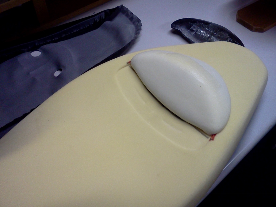

Just picked my PXC up this past few months and love it but hate the seat hump. Only got about 100 miles on it but it feels like I'm being pushed forward and that hump needs to be removed or moved back a tad. I decided to re-cover it in Alcantara also my friend sells this stuff it's the real deal right from Japan. Getting the cover off was pretty easy and the hump only had two bolts the hump cushion is just glued to the plastic piece. I just marked the hump as far back as possible and shaved the back of it and used contact cement to glue it back on without the plastic piece. It made a huge difference for me much better IMO I'm 5-10 170lbs now I just need to come up with A design to sew the cover on using Grey Alcantara with Red stitching will post pics with progress.

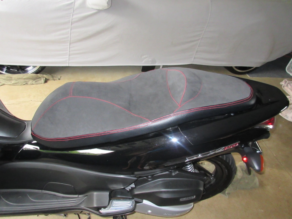

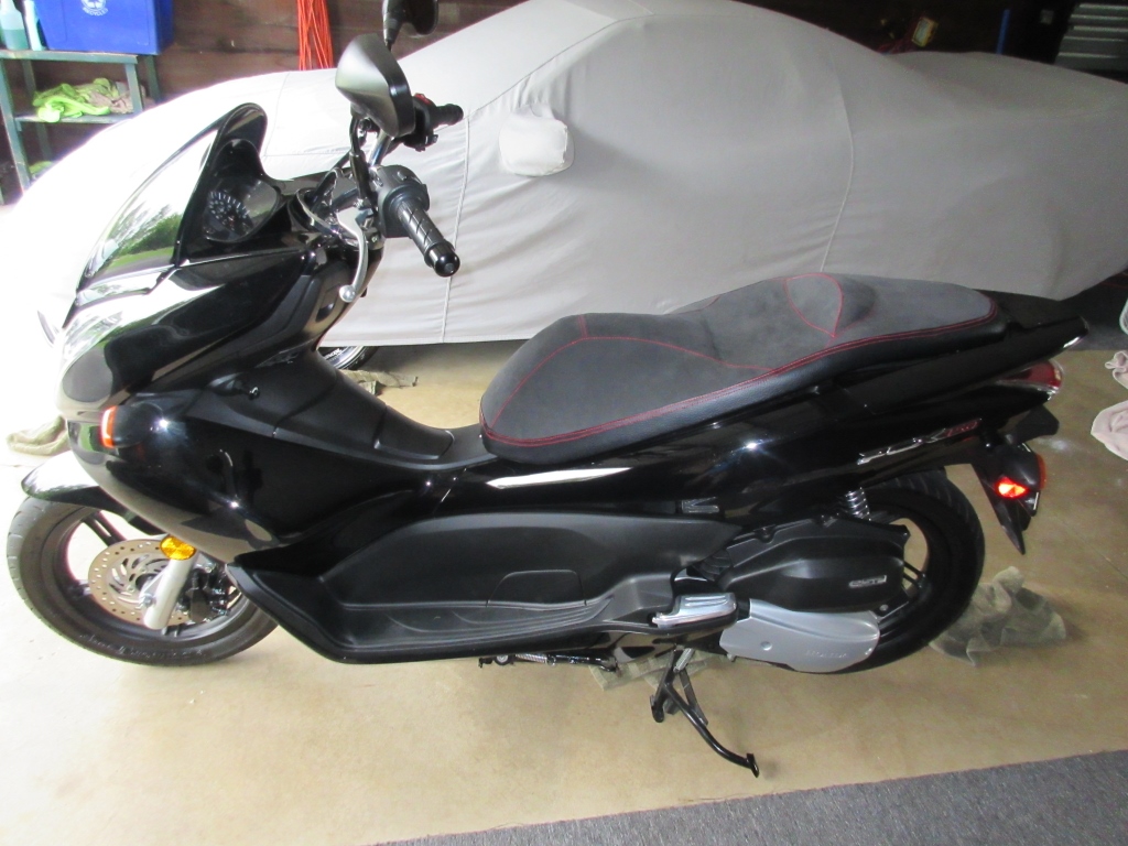

Forgot all about this post I started here are pics of the finished product much better than OEM. Moving the hump back 1 1/2 inches is perfect much more comfortable .

Welcome back sleepy head, dozed off a few months :lol:
That looks very smart in gray but not sure about the red/pink? stitching. Think I would go black. Say, who cares what me thinks, it's about you and It works! :P
Now to be nosey :D What's that ya got under the cover? A sleepy Vette?

Ha Ha....it is Red stitching looks kind of Pink in picture. NSX under there.
Re: Reupholstering My PCX Seat In Alcantara
Oh My!! Reveal thyself NSX!
