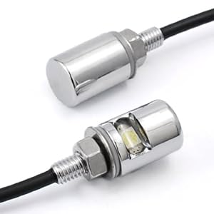

this is what i will install above

Here are the led bolts, i added last night.
