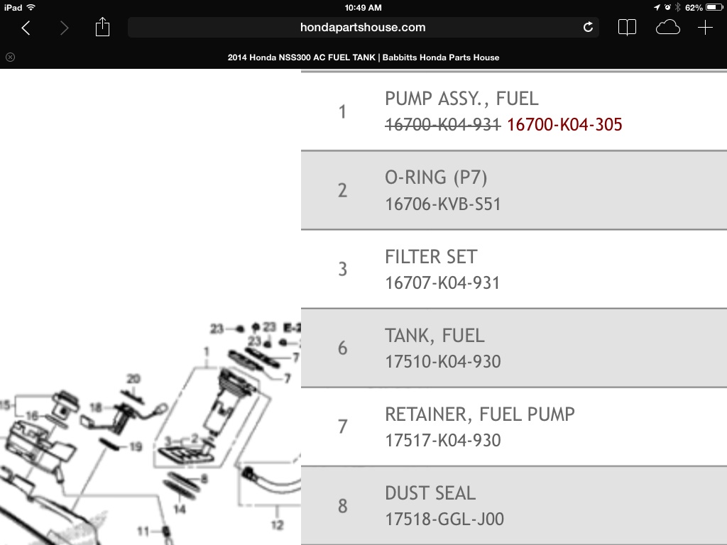

BHaasie wrote:Here is what I know, still waiting to get the call my scooter is ready to pick up, part came in yesterday....
They assured me the latest revision fuel pump part ending in 305 was used to replace the 931 that was in the scooter that went bad....
PN ending in 931 is the Fuel Filter Set (3). PN ending in 305 is the Fuel Pump Assy. (1) which presumably also contains the same Filter PN 931.
