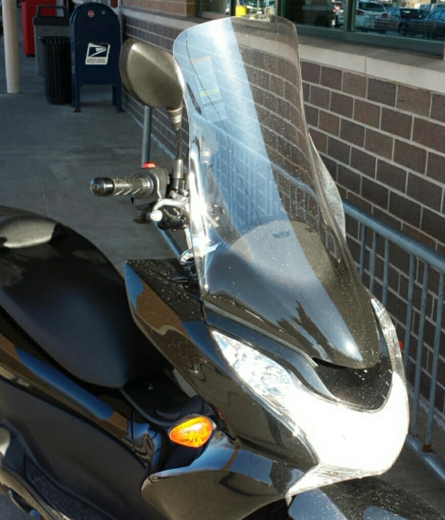

Here's a better picture taken locked up at work.

Mel46 wrote: Look what i finished tonight.. :-) Hope you can see it. Here is a picture of the scooter with them on.
I went out and bought the materials to make the handguards, but immediately ran into a problem. At full steering lock my levers come within one inch of the windscreen, and the mirror mount is a full 2.5 inches inboard of the edge of the windshield edge. I can't see any way to mount these the way you did and not have clearance problems.
You can actually see the clearance in my last post above this one.
Could you explain how you made this work?
The only work-around I can see is to mount them from the bar end weight bolts instead.
Dean
