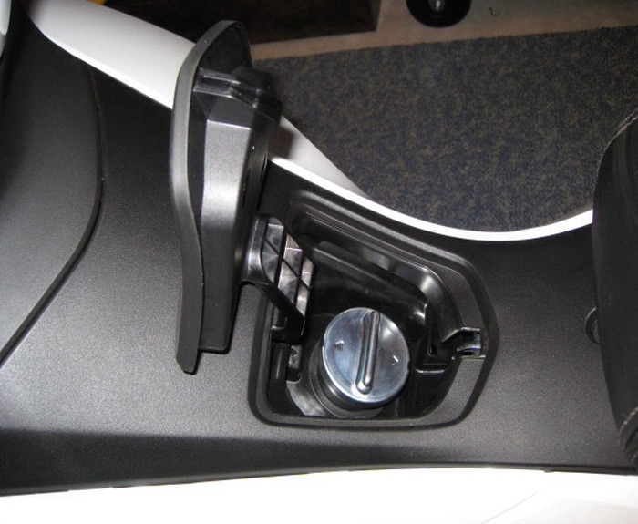

Also it looks like the petrol cap was forced open at some point, so I'll need to bend the catch back. Any pictures out there of what the catch in that should look like?
Thanks for the help.
Re: Seat Latch not locking
Is this what you wanted to see? Here's the best pic I have on file at the moment. Hope it helps. Having a different angle might be helpful too. Anyone?

My petrol cap has a metal catch. I'll take a pic of it and post it. I'll probably take a pair of pliers to it while I'm at it.
Thanks for the pic.

WN is that the first time you opened your fuel access... mighty clean in there
^ Monk visits once/week
Go ahead homie, convince Me that "you're" petrol area is dirty!
Begin.....now! ____________________ .........
