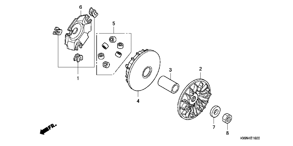

THEORETICALLY, you could increase top speed at the cost of acceleration by shortening the boss on the drive face of the CVT. I haven't tried it, so proceed at your own risk.
Uh, to be more clear, make #3 shorter:
With how many miles you have, you should be able to see how much space is left on the pulleys, to determine how much you could grind without your belt flying off and destroying itself catastrophically. Alternatively, you could replace your weights (#5 in the diagram above) with heavier ones, or some DR pulley sliders to actuate the pulley more, providing more speed.
The Honda drive belt, and a replacement boss in case you attempt my idea, are on mrcycles.com -- the belt (#7 on "Driven Face") is $24.60, and the boss (#3 on "Drive Face") is $3.51. They are available on other Honda parts sites too, but mrcycles is usually the cheapest from my experience.

I realize I might should further clarify why shortening the boss will make the scooter faster... The above assembly sits on the driveshaft of the scooter. At low or no speed, the belt rides in the middle of the pulley, closest to being around the boss. At speed, the two faces come closer together, pushing the belt away from the boss, increasing the radius of rotation, and therefore delivering more speed with less power.
