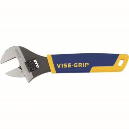

2yous....what's the best size Spanner aka Adjustable Wrench for the drain bolt in its' location (it's a bit confined around that bolt)......a 6" length or 8"?
here's pic of a 6" I'm looking at (grip is cushioned, ahhhh

WhiteNoise wrote:2yous....what's the best size Spanner aka Adjustable Wrench for the drain bolt in its' location (it's a bit confined around that bolt)......a 6" length or 8"?
Either should be fine
Re: How-To: Oil Change For Honda PCX
Good! Thanks
