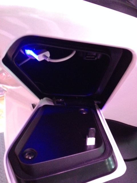

Probably not, with some skill, a dremel and some touch up paint , you could get the door to shut with a space groove for the wire. Easier way is to reroute the usb to a weatherproof recepticle on the dash somewhere. 45 min labor, ill guess
Re: Front Box Confusion

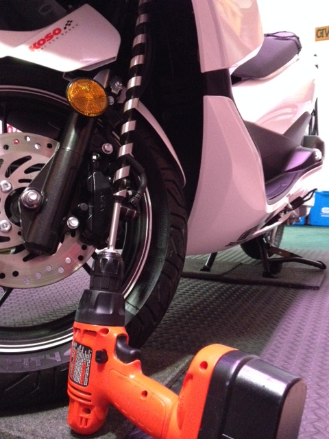

One big hole and you can be graceful drilling it if you must.
Big enough bit to route any charging cords plug through the hole and pull it up the steering column with all the other cables to power whatever you like. Leave nothing for a thief outside the seats luggage box except the power cords :D not even your gloves... too expensive to replace.

Excellent mod....

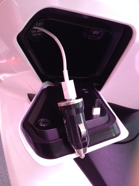

Rode a few times with mine open, with the power outlet charging my satnav.

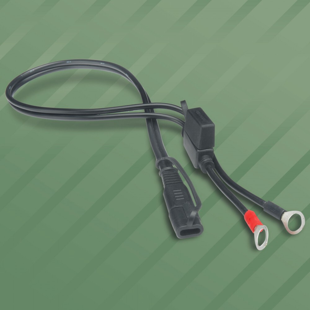

There is another way (without using the glovebox) 12V port to power up your satnav.
Do you have a Battery Tender pigtail mounted on your battery terminals? If so, then you can buy an accessory using that pigtail, to power up your satnav. The pigtail with this accessory wire can remain safely locked under your seat
Here is Deltrane's website: http://www.batterytender.com
And their Accessory page: http://www.batterytender.com/Accessories/
Some pics of what's needed: *(NOTE my comments above each photo)
HAVING A BATTERY TENDER IS NOT A BAD IDEA EITHER. Should you ever need it.

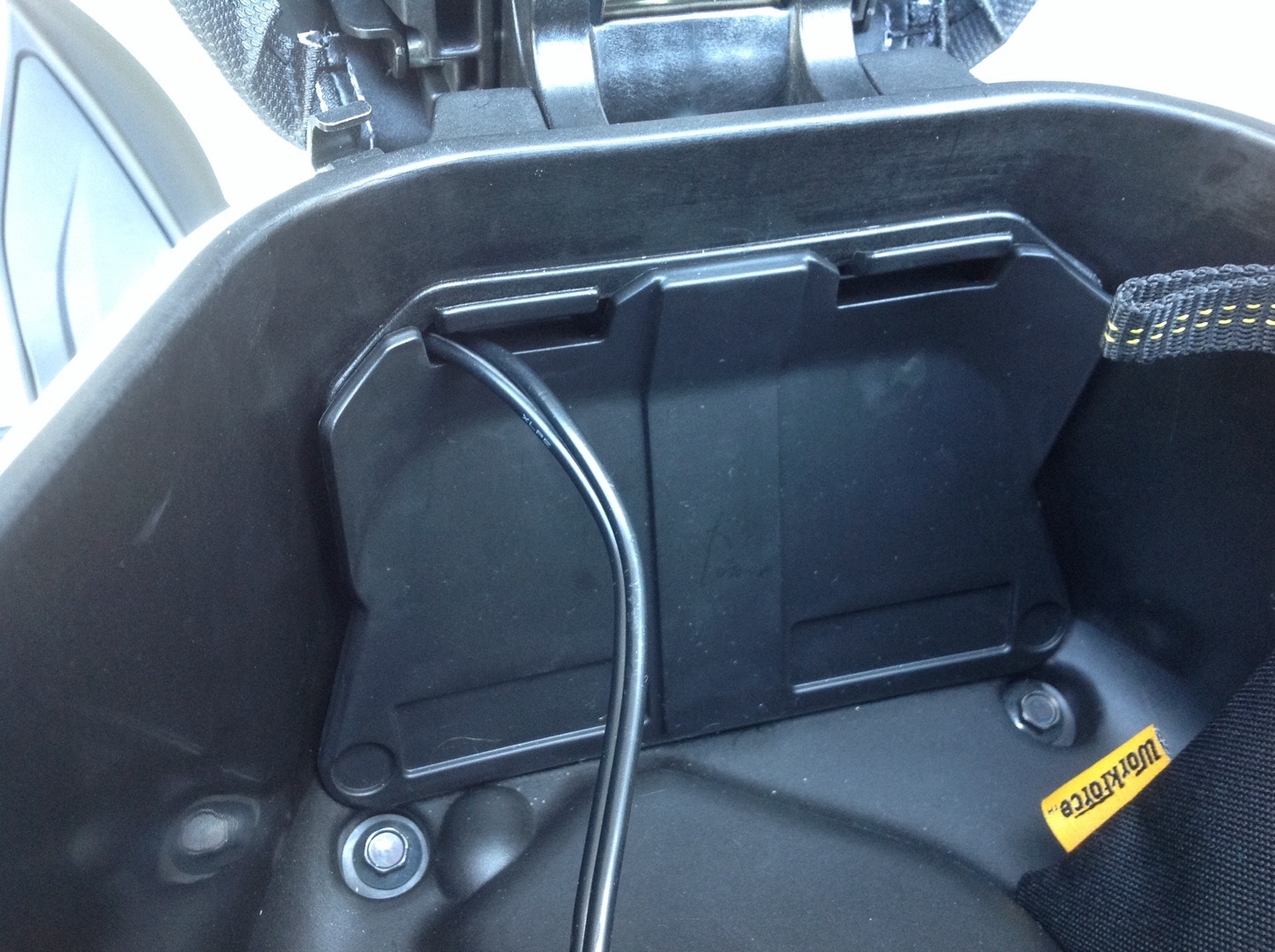

I have a 2015 as well. Below is a pic of my battery lid with the pigtail wire exiting through an existing opening.
The ringed end of this pigtail gets connected to your battery terminals. The other end connects to the

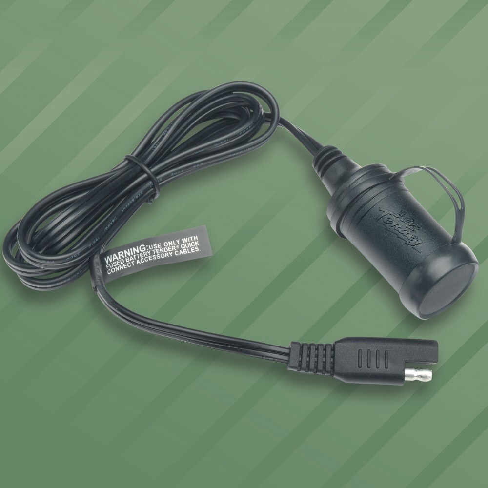

One end onnects to other end of the pigtail shown above, and the other end gives power to your SatNav's cigarette plug
homie :lol: that is some frickin bit! I never saw the bit you used to do this. Wow!
Looking at "that" thing I could think of a few other things to do with that (heehee)....BUT! I will bit(e) my tongue instead :D
I REALLY LIKE how you did this and how you concealed the wiring. Ace job!

Whitenoise is right. Not only is a Batterytender essential, but buying one of those accessories for it is one of the easiest solutions to your problem. One of the first things I purchased after getting the scooters was a Batterytender. Believe me, we have gotten our money's worth from it. There is another advantage that I thought of, that worked well for me. I have a pigtail from my Batterytender attached to my battery. So does my wife's pcx. The Batterytender comes with two ways to connect it to a battery. The first is the pigtail. The second is the clips like battery cables have. We have two Batterytenders because we have two bikes. When my battery died, i connected the clips to the end of the pigtails on both of our bikes, connected those clips together, and started my bike off of hers. Presto, jumper cables built in.

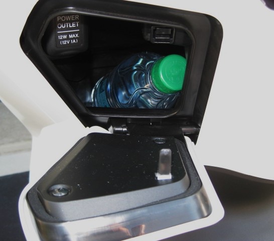

Nexxiss wrote:I have actually been thinking about putting foam in the box - and cut a slit for my phone/ipod - but I love the ideas
Noo...don't. Did you know that you can fit a 16.9 fl oz bottle of water in there and snap the door closed? No excuses now for Not staying hydrated. Stash a few ounces under the seat too.
Seeing is believin' :D
