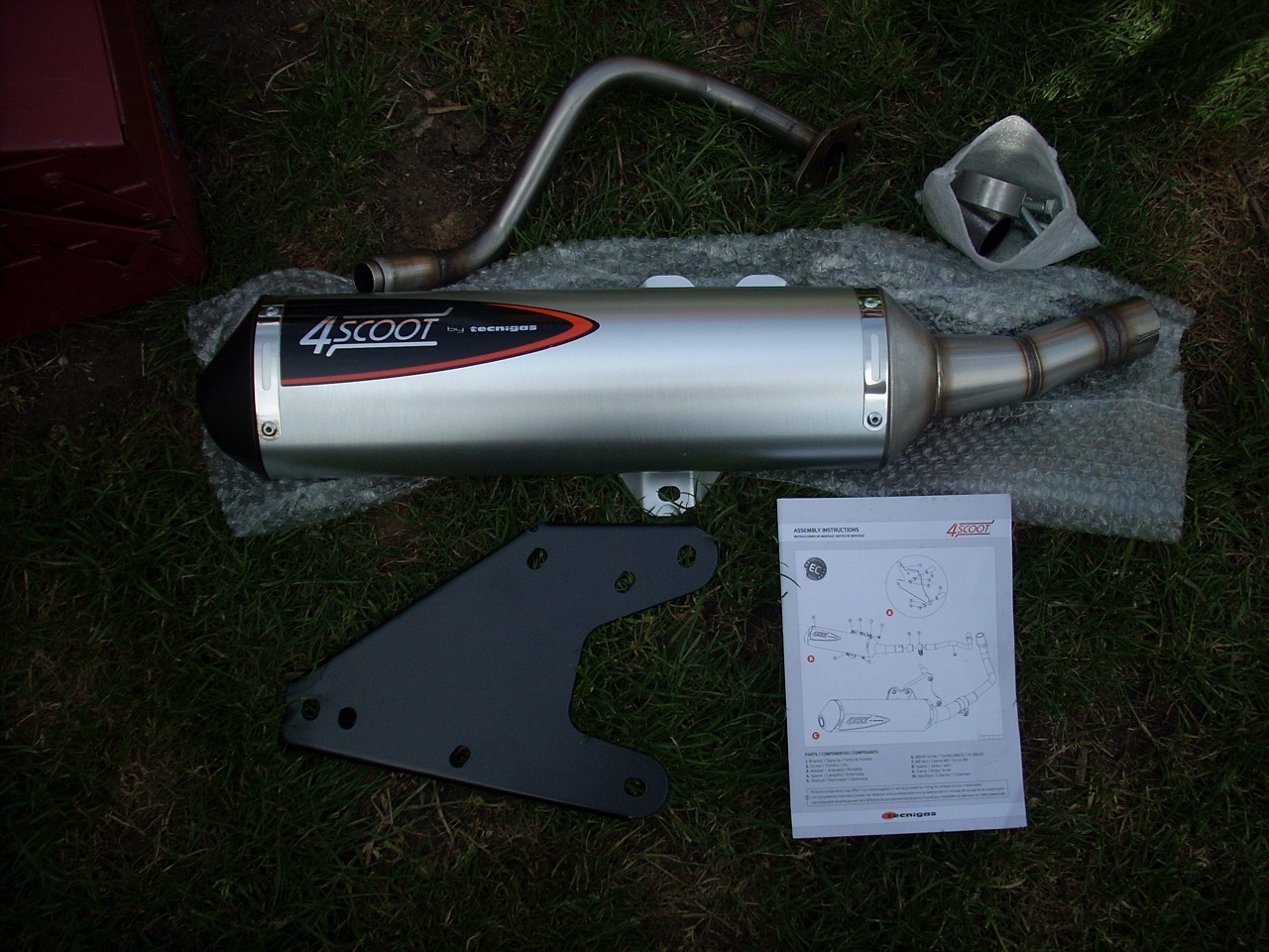

I've have fitted a very nice exhaust to my PCX 125 esp for thelast 500 miles / month or so.
It's a Tecnigas 4 Scoot, does the business and is only £168 delivered here in the UK from Pedparts.
I have had this same exhaust fitted to my SYM Jet for the last couple of years (which my Son still has as his daily ride) so can vouch for it's longevity.
It comes in a full kit as shown below with a nice stainless primary pipe & aluminium clad silencer.
I wasn't at all happy with the fit onto the large black steel bracket which seemed to put a lot of strain at the join between primary pipe & silencer.
I got around this by knocking up another bracket at work on nights, but worth bearing in mind if you buy one, it may just be my bike / kit.

The pipe looks good, I consider it good value for money, sounds good but not too loud & does boost performance.
I suspect it raises the power output slightly (no cat), but probably raises the power torque curve too, so loosing some bottom end.
Although acceleration times are the same as before on paper, acceleration at 50mph plus is markedly better, & most of all average top speed (GPS) is up from 57mph to 60mph.
To bear this out I tripped up the A5. At my usual black spot I was down to 50mph minimum on the worst hill with trucks bearing down on me.
1 hour later, same road, same conditions, new exhaust fitted 55mph minimum......nuff said

Yeah Tomtom,
I agree, the exhaust is great but the bracket simply didn't fit.... or rather the bracket fits perfectly and is very well finished. I would suggest the header pipe angle is too shallow where it comes up to meet the silencer.Bear in mind this is stainless so you ain't gonna bend it without heat.
I could & maybe should have just returned it for replacement but guessed that the pipe is probably bent on a jig & so all of that batch at least would be the same.
Anyway, for me I had scrap steel available and a whole night to spend on it so it was a good way out.
Then again, maybe something is out of alignment on my bike???
Either way it's performing great.

Just a quick photo I took at the time of fitting.
It shows where the exhaust sat without strain at the joint. It could have been forced into line but the bottom mount was then way off too. Also if I had redrilled the two top mounts in the position shown, the bottom mount was below the mounting plate.

I made this mount up out of a piece of scrap then drilled the silencer holes in situ.
Not that pretty but effective.
I may knock something nicer up when a piece of ally plate comes my way.
- mount.jpg (476.39 KiB) Viewed 7198 times

Hi Waspmike,
Yeah just checked the box & Pedparts site, it is indeed the correct exhaust for the esp 125, in fact this is the only model covered according to the Tecnigas site.
- tecnigas.jpg (294.6 KiB) Viewed 7119 times

It was just a thoughtBlubayou wrote:Hi Waspmike,
Given that you have the skill to make a new bracket I assume you loose fit the whole system before tightening everything. But looking at the way the silencer connects to the down-pipe there doesn't look like much wiggle room. Again why I initially suspected the wrong model.Blubayou wrote:Incidentally Pedparts price is very keen compared to the rest of the interweb!
http://www.pedparts.co.uk/product/2809/ ... -pcx-125cc
Is that because they don't quite fit???

Ha ha, wiggle room! Spot on description!
It's exactly that, there isn't a lot so it will fit on the original bracket but boy is it under a lot of strain.
Anyway, it's on with a home made bracket, working a treat, looking & sounding good if anyone else fancies one.
Oh yeah, it's 'E' marked too.

Well its just that your trials and tribulations may put others of the pipe. Maybe a quick word to Pedparts just so they realize they may lose a customer or two.

Of course it will put people off- all those who don't have access to a worshop and willing to spend hours fixing what should really be a plug and play solution to start with. Take the labor hours into account and suddely the price is not so attractive anymore.
A last thing, would fitting the pipe and then torching the pipe carefully ease the strain without having to build a bracket from scratch? Just a tought - That i would'nt be very confortable doing to avoid a) Desoldering one of the joints on the exhaust itself and b) putting too much heat on the cylinder head.

I would have to agree....I don't mind taking a Dremel to a part to clean up some production metal flash, or whatever, but major mods to a brand new part seems like I'm doing part of their job for them. It would be immediately going back if this was mine. There are many that fit no problem and just my opin, look better.waspmike wrote:Well its just that your trials and tribulations may put others of the pipe. Maybe a quick word to Pedparts just so they realize they may lose a customer or two.
