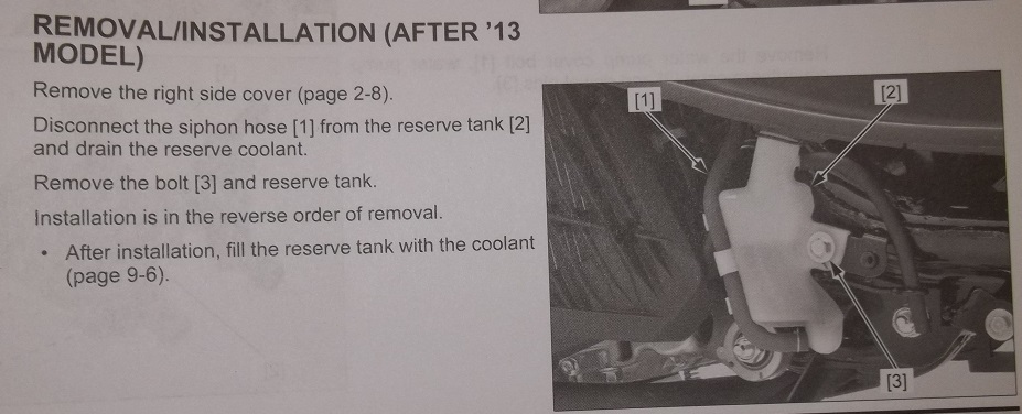

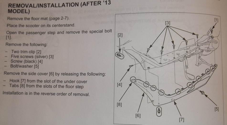

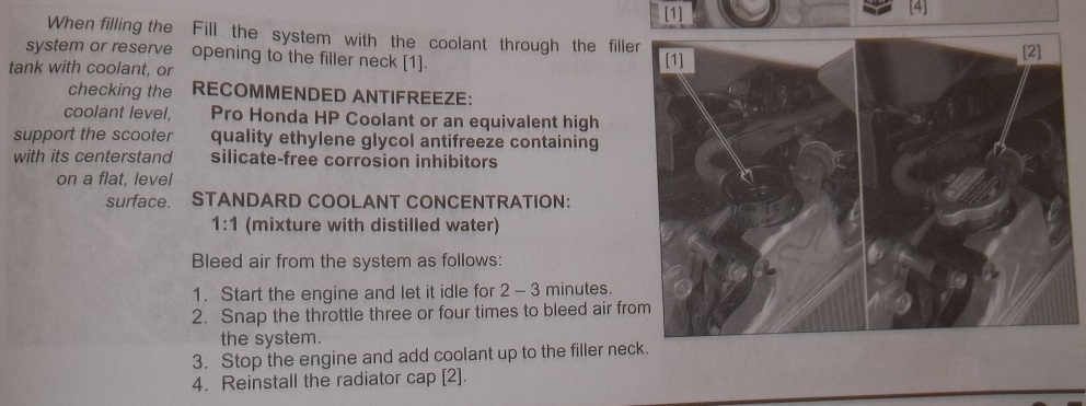

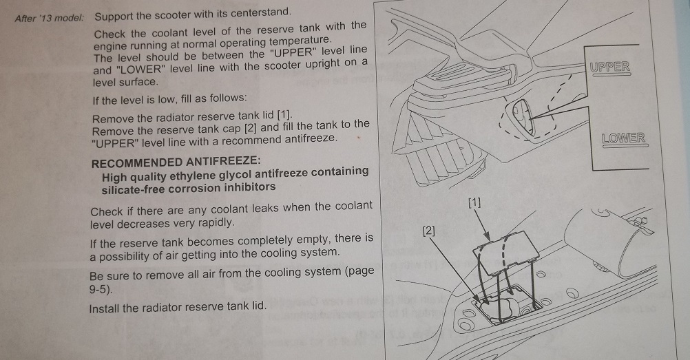

Or you could sort it out yourself If its reserve tank issues you have surely you can manage without a dealer and their fees. Here is everything you need to get in there and look at the reserve tank, hose and connections on a 2015 PCX. If you find a leak order a tank or replace a hose. If you are pouring coolant in the right place
and it runs right out on the floor then you can fix this.
1. REMOVE THE SIDE COVER
2. INSPECT THE RESERVE TANK AND HOSES
3. REPAIR OR REPLACE HOSE, TANK OR ANY CONNECTION
4. FILL RESERVE TANK AND INSPECT FOR LEAKS
if you are felling cocky at that point drain the main tank and follow instructions for filling and bleeding air from the coolant lines. BEWARE IN YOUR COUNTY THEY MAY FOID YOUR WARRANTY FOR TURNING A BOLT.
