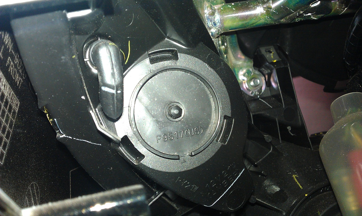

I think adding a bulb to the side lights is very possible...
Just drill out the old "P9517(US)" and attach a "1156" bulb or similar small bulb and fixture.
Of course attaching the fixture will be the hard part, but a small bracket to hold the fixture should work...
