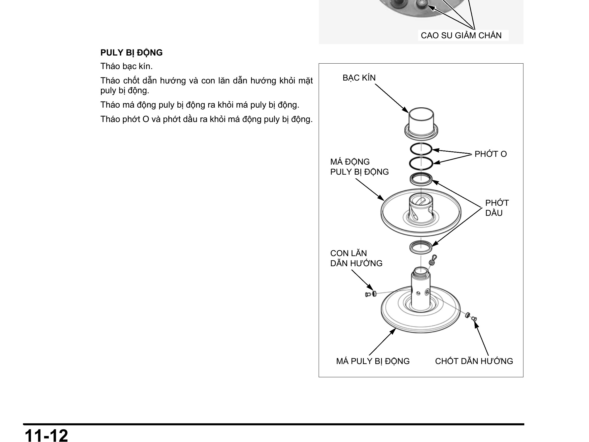

If it's anything like the pcx it's got a big nut on it once the clutch bell comes off. Then it's spring loaded when the big nut comes off. There's a collar that's then removed then pull out the pins that slide into the slots so the 2 parts of the pulley can be separated.

Taken from pcx manual
- ImageUploadedByTapatalkHD1456674252.599835.jpg (196.12 KiB) Viewed 5561 times
- ImageUploadedByTapatalkHD1456674243.723749.jpg (298.88 KiB) Viewed 5561 times

Cheers Alibally, those illustrations of the proper clutch holder are very useful.
