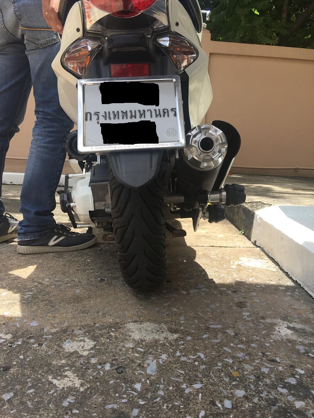

No, you are right about the front/rear/mainstand issue, Chicaboo correctly made comment of that in another post. Well maybe I'll test fit them and take a look since I have the tires already, can always swap them back. Any chance of a rear wheel pic from directly behind when you have a spare moment? Thanks for all the info :)

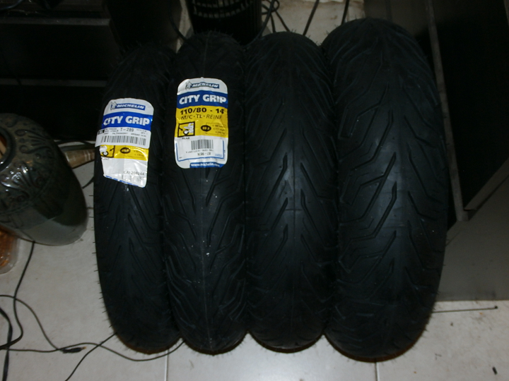

Meanwhile I took this pic of the city grips, from L to R 90/90-14, 110/80-14, 120/70-14, and the 140/7-14

Here is the best I can do K2. Not very good, but hope it helps. I doesn't seem like any pinching is happening.

That pic is perfect Kramnala, thanks!

Video was great homie, but the tire was in shadow mostly, or the camera was zoomed or focused in on the spacer mods to get a good look at it. I wanted to see how the tire 'sits' on that rim ans see if any width is lost to pinching. I love the whimsical lol. Cheers Buddy.
