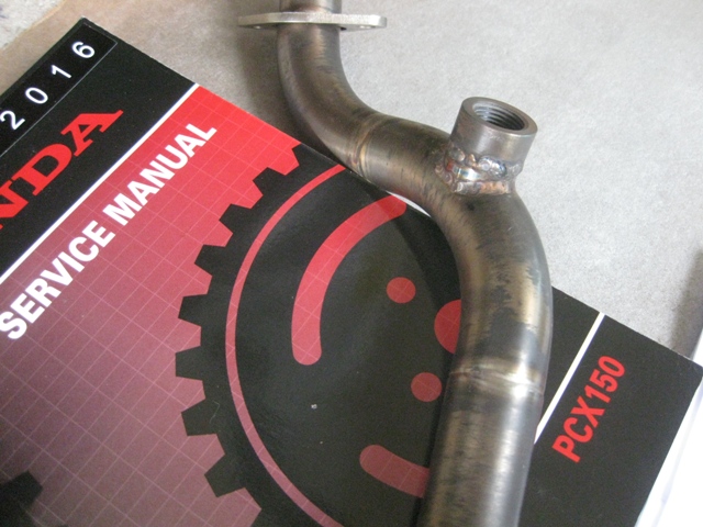

Had to weld in the bun

Pic 002.JPG (146.56 KiB) Viewed 8700 times

Yes... 13.9 is NOT very fuel efficient... But, who cares if your bike is running at it's best and sounds great... and 13.9 it is excellent for making more power... truly noticeable as I for the first time... accelerated going up hill... instead of loosing speed - I can gain speed going up hill...
and Yes, NOT good under hard acceleration... but, truly better under nice roll back on the throttle... as gaining more power through the entire RPM climb... not bogging down.... because the engine is making more horsepower...
Summary - I am Very Happy with the performance using the Wideband 2... enjoy the know what my AFR is doing... and exhaust sounds better... tight crisp sound...
PS... I tried 2 of those fuel controllers... you know click 1 click 2 click 3 - 4 5 6 etc... all junk in my book... because these fuel controllers are NOT adjusting AFR versa TPS - not monitoring your AFR.... only dumping more fuel... so, I "Dumped" mind right into the trash can... and caulked it up to lesson learned... expensive lesson learned
ThailandPCX
Posts: 31
Joined: Sun Jul 05, 2015 6:30 am
Color: matte silver
Re: Fuel Controller - DynoJet Wideband 2...!!!!!
Post by ThailandPCX »
Hello Chicaboo...
Hey Dude.. I read your whole series of High Performance Mod's... WOW - Dude...
So, really... I am unable to comment on how the Wideband 2 might work out on your bike...
And I am limited in my knowledge too.. I only know that to develop horsepower... and I read... AFR 13.4 for hole shots off the line because you quickly open your throttle body and mass amounts of air are dumped into your engine so for this you want a little bit rich condition - so, I read.... and sure... you can lean out 14.5 for cruising speeds... better cruising and better economy fuel... but... unless you have a truly ECU that you can 'Map' at per TPS.... and build multi maps for.... round town riding... cruising open roads.... and Drag Race... Quick Open Throttle.... etc
I am Very Happy with my performance of my Honda PCX with the Dynojet Wideband 2.... and AFR set at 13.9... gives me the best of both worlds... More Horsepower... through a more wide range of conditions and RPM's...
PS... I tried 2 of those fuel controllers... you know click 1 click 2 click 3 - 4 5 6 etc... all junk in my book... because these fuel controllers are NOT adjusting AFR versa TPS - not monitoring your AFR.... only dumping more fuel... so, I "Dumped" mind right into the trash can... and caulked it up to lesson learned... expensive lesson learned...

ThailandPCX - I'm talking about proper fuel controllers, like a Bazzaz, PowerCommander, or DILTS Japan, which allow proper fuel enrichment mapping along ignition timing adjustments. These are best used for the closed loop portion of the operation.
Chicaboo: the good thing is that on a scooter engine load is well represented by throttle position or RPM so no need for air flow sensor to be used.

Hello Oyabum....
certainly.... I will be happy to comment on the Bazzaz and Dilts Japan.... Dilts Japan from Webike Japan - right....?
first I must apologize to Dilts Japan Engineers... because what in the 'hell' were you Japs thinking...
My Dilts Japan... had one - installed one - un-stalled on - and can say (if possible) 200% JUNK... Dilts Japan is NOT a map unit at all... does not monitor the AFR so how can you even begin to set-up Dilts... Dilts map graph is even stupid as shit... 'Y" axis is TPS and 'X' axis is RPM... Well, Dilts - where in the heck is your AFR... and Dilts does not have a set-point... Nothing to get your starter.... and there means of Fuel Control.. like I said... How - when the unit is not geared towards monitoring - adjusting your AFR... there means of adjustment is in microseconds... you can adjust how long your injector will stay open.... and if this isn't bad enough for you... their range is like 300 microseconds to like 2,000 microseconds... well - again with No means to control your AFR with the Dilts... where in the heck to you start... 500 microseconds or 800 microseconds or 1,500 mircoseconds..??? So... Dilts was my first $12,000 baht mistake... lost my ass on that one...
You also mentioned Powercommander - from DynoJet... Sorry to inform you... there is No Powercommander V on the market... and DynoJet has No Plans to put one on the market... they already tried... and could not get any better improvement... no real noticeable increase in Horsepower... So, DynoJet decide not to introduce a PowerCommander V into the market for the PCX because... why..??? would it sell..???
Sure - I can also comment on the BAZZAZ... first.. try to contact BAZZAZ... try to get any form of "Customer Service"... I tried for months to talk with somebody... and I tried all 3 ways... (1) email - No Response.... (2) left a customer support ticket through their website - No Respose... (3) left a message on their YouTube video - No Response... So BAZZAZ - Kiss my Lilly White #$*^(^@#... because to me... 100% Good Customer Support is a "Requirement"... so, BAZZAZ- No Response - No Sale - No Buy
And after talking with Dynojet... their chief engineer Chris... since the Stock ECU runs in "Closed Loop" "continuously... there is nothing you can do to change this.... because is you could change this... believe me DynoJet would have a PowerCommander V on the market...
So, I am glad again - I did not buy the BAZZAZ Unit - maybe just another worthless piece of junk for the PCX...
And Dude... the Wideband 2 is made by PowerCommander - DynoJet...!!!!
