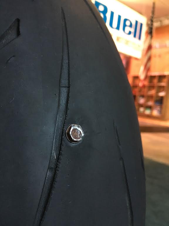

Is there anything I can do about this or am I.... screwed

I have heard of riders getting their tires plugged but I am not sure how much I would trust it for 'continual' riding. It may work out till a replacement tire arrives though.

When it is near the sidewall, it is definitely something that should be replaced, and though yours is not too close to the sidewall, it looks like it is a fairly good size. Thus, without seeing the diameter and just going by the size of the head, I would say you are screwed, to use your term.

Dang... there was still some decent tread and of course I will have to do the front too. Fall is the BEST and I'm off the beasty
I don't want to get in line or even know what new rubber and mounting cost in Chicagoland. I doubt the fellow who puts my PCX tires can handle these rims and I'm not willing to test him. Ah shucks, Oh well... come on little Honda
Re: inspect before every ride...
EW! and it's rusty! Plug that tire, inflate. Let the mighty Buell rest. Ride the "precious," renew your vows, feel the love
Seek a fall/winter tire sale. Got beer? Attempt mounting.

From the wear bar to the right of the bolt head it looks like that tyre was due a change anyway.
Bigger tyres on bikes are easier to change than small scooter tyres so have no worries about your tyre man changing it.

Found a guy with a machine and two sets for sale, Pirelli Diablo's and slicks used once on the track which means all four only have half life left in them. But the price is right, I get some choices and experience and the guy races knowing his tires so I'm meeting him next week with my wheels in tow.gn2 wrote:From the wear bar to the right of the bolt head it looks like that tyre was due a change anyway.

Studded tires: you're doing it wrong.homie wrote:Is there anything I can do about this or am I.... screwed

Plugging a motorcycle tire halves its speed rating. Kinda like putting a donut on a car, it will work to get you to a shop, but should not be trusted for regular use.Mel46 wrote:I have heard of riders getting their tires plugged but I am not sure how much I would trust it for 'continual' riding. It may work out till a replacement tire arrives though.
