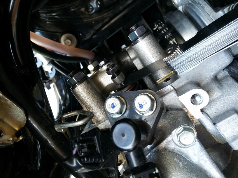

Hi all.
Long-time reader, first-time poster.
I decided to check the valves since the engine has started to sound a little clicky, and the bike's just reached 14,500km (it had 4000 on it when I bought it, and I don't know whether the valves were checked during the prior ownership). So, equipped with the service manual, I proceeded to strip everything and, finally, to check the intake. It was quite out of spec, so I adjusted accordingly.
Having done that, I tightened the nut and for some unknown reason the valve gap/clearance had been reduced to nothing when I rechecked (but the valve adjusting screw had not moved - i.e. I held it in place with a tool when tightening the lock nut). Scratching my head, I again wound the crankshaft & radiator fan to the TDC settings and there was no change: the rocker moves but there is no slack. Despite repeating the crankshaft & radiator process several times, there was still no gap. I even tried both loosening and tightening the adjusting screw and still no clearance.
Hoping with little optimism that starting the engine might break it loose/open it, I reinstalled the cylinder case, reconnected the battery, and fired up the engine. It wouldn't start.
Any assistance would be greatly appreciated.

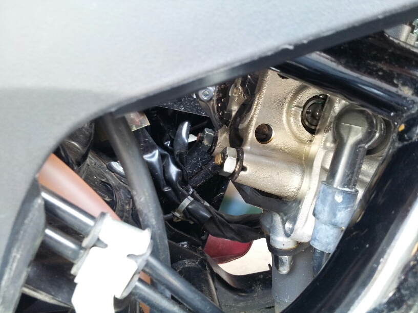

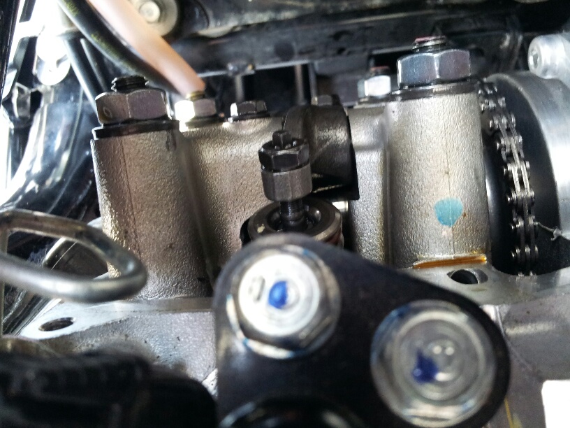

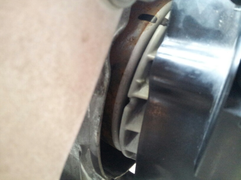

Hi Lafree & Easy Rider,
Thanks for your responses - really appreciate it.
I just had another go and no change.
As you can see from the images, while TDC is set, there's still no gap.
Any ideas?

Re: Intake valve seized/won't open; no clearance after adjus
You have the valve adjuster adjusted as tight as it will go. Proper adjustment will have threads above the lock nut.
Hi Pcxman,
Well spotted - thanks.
Yes, I didn't have it that way when the problem first appeared, but must've done that when frantically loosening and tightening to get clearance.
I think I've solved the problem. Although I've been aligning everything correctly, it turns out that the radiator fan setting doesn't sit naturally on the line (no matter how many times I wind it; it's only off by around a millimetre/.039 inch). Accordingly I jammed a screwdriver in to lock it right on the indicator, and now I can fit in a feeler gauge!
Will set it, re-attach battery and report back soon.

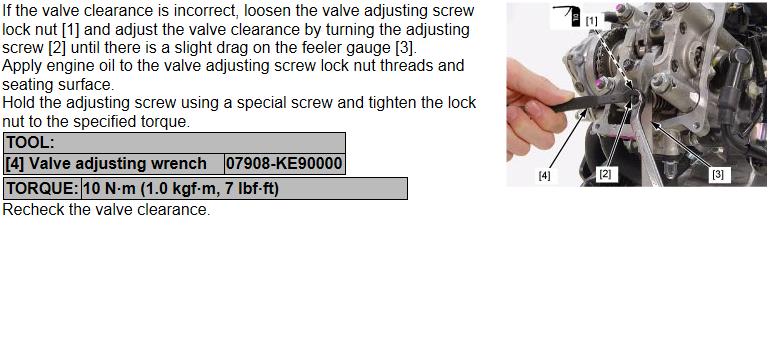

Thanks for the additional info and tips guys. Yes, the manual mentions the exhaust cycle and to do another 360 turn. I tried this several times to no avail; it was still slightly off.
Engine starts now but there's still a rattling sound, although not as bad as initially.
I'm now redoing the clearance but am having a problem with the lock nut (interestingly, the abovementioned fan alignment issue is now gone). In the image you can see how far it it is from the the rocker, and while I'm able to get it to about halfway by means of a 9mm wrench and pliers, I'm now encountering substantial resistance, to the point where tigthening any further sees the pliers slipping off the square head of the adjusting screw. I'm a little worried about applying more force because I don't want to strip the square head. I've visited several hardware stores and all I get is a blank stare when asking for a tappet wrench (the part recommended in the service manual states "US Only"; I'm in AU). I did, however, find a kit on ebay that seems to include one that is the right size (looks to be either a 3mm/.11 in. or 4mm/.15 square head?).
After taking the attached photo, I decided to remove the lock nut and apply liberal amounts of engine oil to both it and the adjusting screw shaft. It helped a little but still can't get it to where it needs to go.
Looks like I'll have to order the tool and wait for arrival. That is, unless anyone has any ideas?
Thanks again all - really helpful.

Have to use 2 hands same time with tool in each af them.
If you make it first time- it is normal that you was not success at the first time. Just some more practice are required
- PCX valve.png (136.63 KiB) Viewed 6812 times
