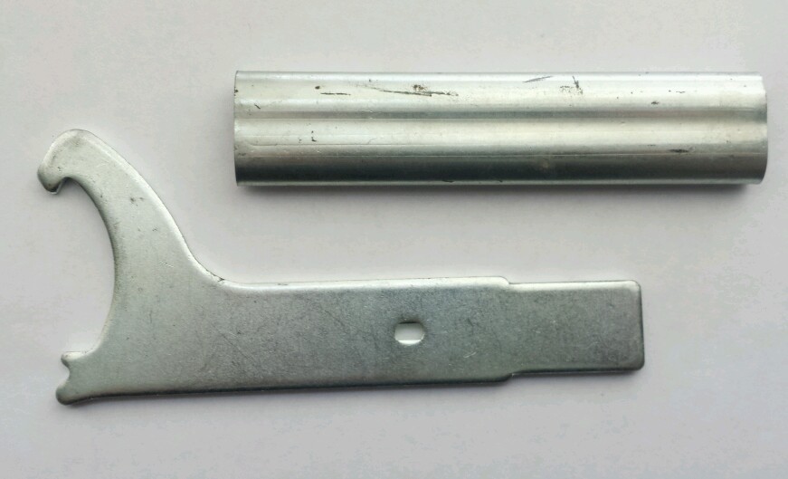

FORZA SPANNER WRENCH AVAILABLE FROM US DEALERS NOW!
I finally got Honda to make their Forza Spanner Wrench available from US Dealers. Order "both" parts thru your dealer as follows...
Part # 89215-KSV-J00 SPANNER, PIN
Part # 89219-KSV-J00 HANDLE, EYE WRENCH
Same Part #s as in the Non-US Honda Parts Catalog on Page 104... see attached pic.
The Honda Corp Rep said they s/b about $15.
- Honda FORZA Spanner Wrench Parts Page Pic.png (46.88 KiB) Viewed 6615 times

I ordered the two-part Spanner Wrench from my local dealer yesterday, 11/20/14.
1) They expect to receive it in about 3 days
2) Total Cost was $14.18

In case anyone is wondering, all of the online Honda parts fiche sites now also stock the Forza shock absorber spanner/tool and handle....
I just received one from CheapCycleParts which I ordered along with some bolts, gaskets, and oil, air and fuel filters for future maintenance.
I have to say it works much better than any alternative spanner I've found...if you have a Forza, get one!
Thanks again!!
