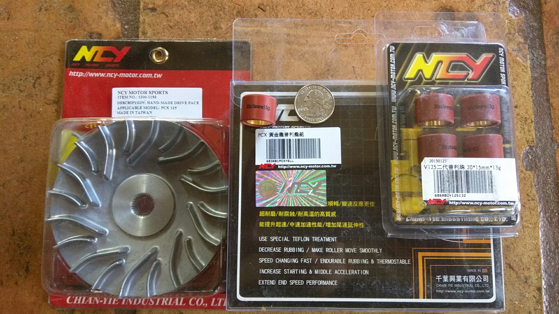

Re: Rollers vs Sliders ? Which is better
Here is a picture so people can see what they would be getting if they choose to go with the rollers and NCY.
I chose these rollers because of availability in USA, and because they work with the aftermarket pulley/drive face. I want both quicker acceleration when needed and higher top speed when needed. The stock PCX 150 is good enough 90% of the time. I am adding these for the times I might need to get on the highway and go 65mph and provide a little more getty-up off the line.
