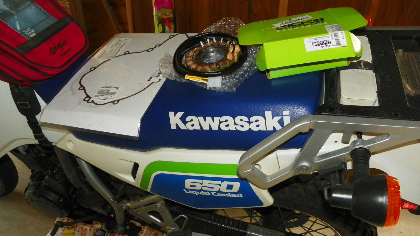

Got the new "aftermarket" stator today. ... :D
Hope it's going to be OK. Time will tell. The company got good reviews so I'm counting on the reviewers opinions. :|
That said my machine is 31 years old. . .was an '88 model built in '87. The older they get the more challenging to get parts but so far so good with the KLR. Usually I always get OEM but this stator was half the price and saved me about $200. :geek:
As soon as this tropical heat wave passes I'm going to install it and will provide some pics along the way. :roll:

OK. . .so at least I finally drained the oil in the KLR today and am looking forward to getting the stator swapped out with the new one this week. :D
That said, before I remove the tank, I want to make sure when I disconnect the fuel line/vacuum line to the carb I don't make any foolish mistake. I haven't removed the tank in years and since the gasket inside the fuel petcock may not be "like new" I want to proceed with caution and have a container on standby to receive residual fuel from the line and disconnect with caution. I have the petcock set to "off". It only has "on", "reserve", or "off". o_O
Since this bike is over 30 years old and never been crashed or laid down it is a good specimen as an antique.
Here are some pics. Rome wasn't built in a day so I'll browse through my KLR service manuals tonight and make sure I'm prepared. I wish I hadn't filled up the tank the night I took it for a ride last Summer when I discovered that the electrical system wasn't charging properly. It's probably got at least 4 gallons in it. . .maybe a little more. I usually like to do these kinds of projects with very little gas left in the tank. :roll:
