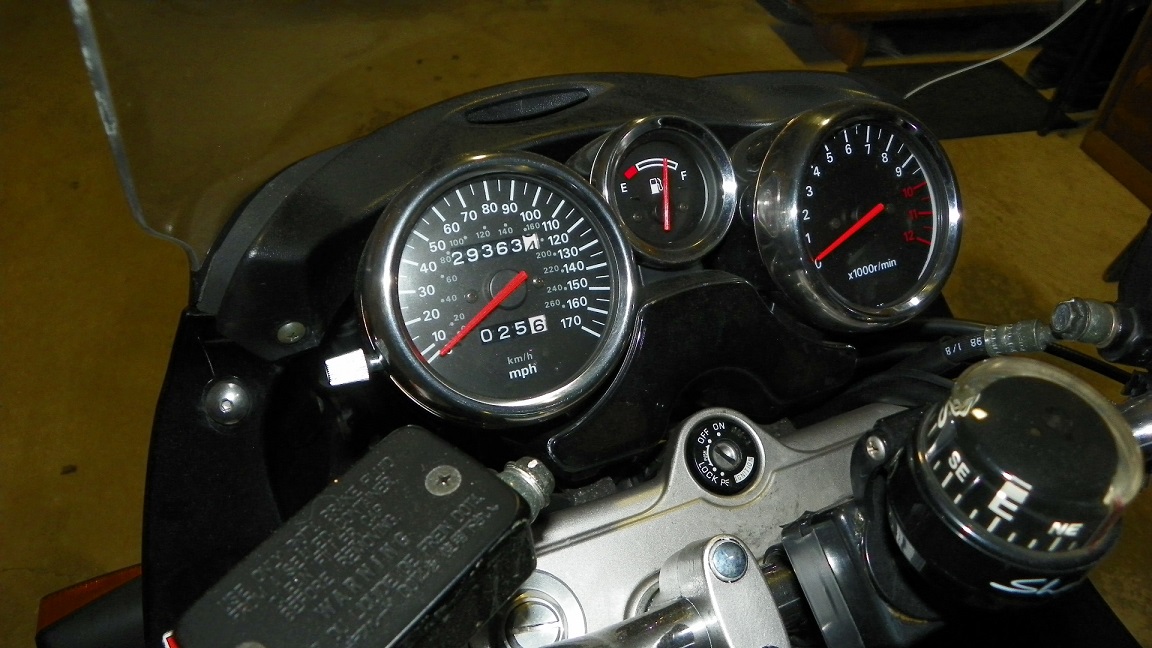

BTW last night I went to check the tire pressures on my Suzuki Bandit (you can just see the gauges and windshield in the above pic) and believe it or not the rear tire valve stem just broke off in my hand. I first thought I heard some "hissing" and felt some air on my fingers. . .and the more I pushed the tire pressure gauge on the valve the more it hissed. Couldn't believe it. In all the 45+ years of riding motorcycles I've never had a valve stem just break off like that. I haven't put that many miles on that rear tire either. . .been really busy. . .had it replaced in late 2012. . .so it's not like it's really old. I know tires have a shelf life but for a valve stem to just break like that makes me wonder about what else is out there on the market. You hear so much about vehicle recalls these days. My advice to anyone riding on two wheels today is to think safety first on the important things. Don't take anything for granted. :geek:
