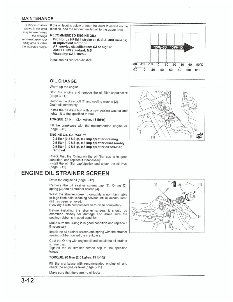

Is it fairly easy to change the oil myself or should I get it done again? I’m such a newbie and I have no friends or family that ride.
Re: Fuel Cleaners
Changing the oil should take no more then 30 minutes, though I have done mine in 15 minutes before.
Just be careful of the oil drain bolt. Some people have gotten in a hurry and ended up rounding the head. It is under the bike so you sort of have to hold the socket on the bolt to keep it from slipping. Put newspaper under the bike before you put it on the centerstand. When the oil drains out (less than a quart) in will probably run down the centerstand a bit. That is how close the drain bolt is to the centerstand. (If you can find a way to hang the bike from the ceiling you won't need the centerstand, but I haven't found a way to do that easily yet.)
There is also a screen on the opposite side that can be pulled and cleaned. You may or may not opt to pull that the first time you change the oil. They probably did it at the dealer, but you should ask, just in case. That is where any bigger particles will be captured. If the dealer pulled it when they changed the oil, don't worry about it until the next one you do other than your first time. Give yourself time to gain some confidence.
Re: Fuel Cleaners
This might help you.

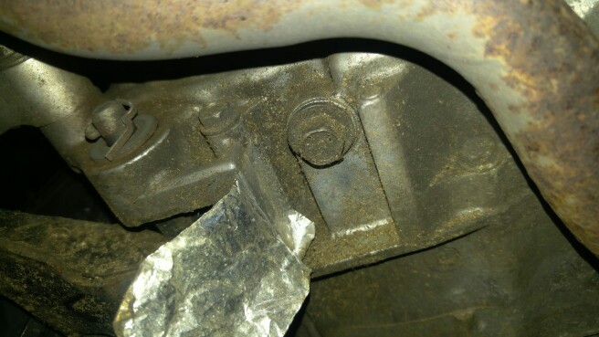

I got around the dripping oil thing by sticking a bit of tape - in my case some aluminum tape - onto the scoot before I pulled the drain plug. The tape redirected the oil away from the center stand. I still made a bit of a mess - newspaper or cardboard are still highly recommended. BTW - I took this pic just now. The tape has been on for over a year.
Or get an oil sucker pump and never bother with the stupid drain screw. You may not get every drop, but you will get most of it. This is You² preferred method.
The trickiest, most frustrating part for me was putting the correct amount back in. Sneak up on it - full to overfull seems to be about a half ounce.
Aluminum tape deflecting oil drain from centerstand-656x369.jpg (65.24 KiB) Viewed 7508 times
