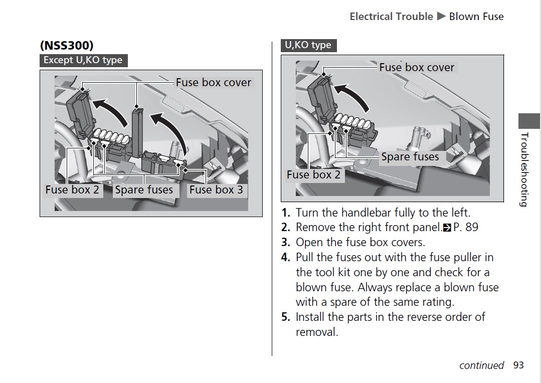

I looked at the regular user manual that came with the scoot. I found actual, useful information.
blown fuse 1.jpg (149.68 KiB) Viewed 6024 times
blown fuse 2.jpg (150.65 KiB) Viewed 6024 times

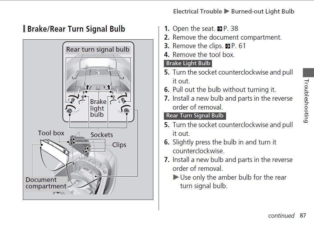

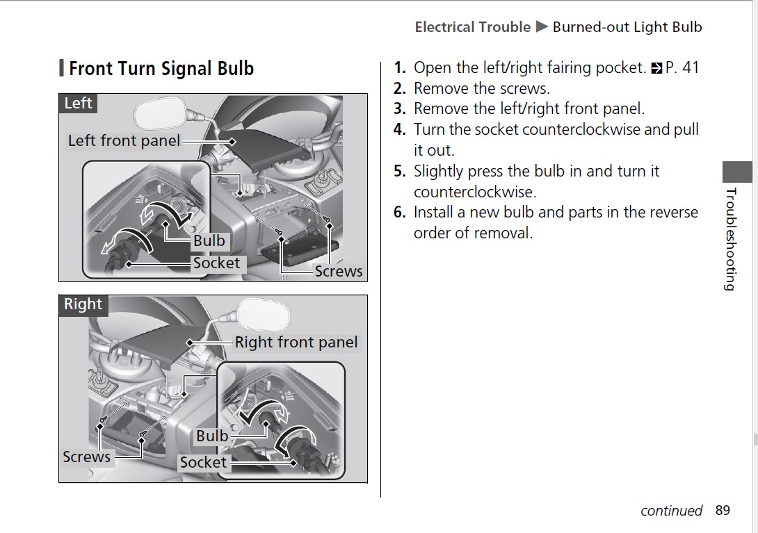

While I am here, and on the off chance that some screwy power surge toasted the fuse AND both brake lights....
brake light bulb.jpg (168.08 KiB) Viewed 6024 times

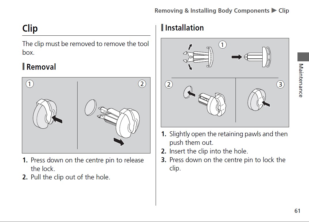

And the mysterious clips, which I fiddled with for at least fifteen minutes when I first met them:
I was pretty happy with myself for figuring those clips out.... Too bad I didn't just RTFM.

Thanks for showing me where Fuse Box B is located. I tested all the fuses and they are fine. Dang, I was hoping for a simple fix, but alas it escaped me. I assume the fuse in the fuse box hidden under the seat by the battery is the main fuse and should not be under suspicion.
