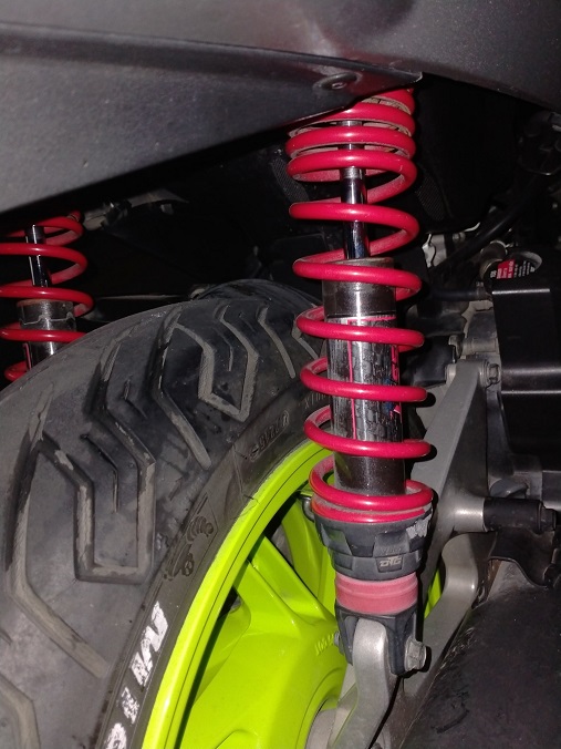

Update:
I finally found a PCX that actually did what I had in mind and I didn't like what I saw.
Looks like the rear wheel will fit, but look closer..
The clearance between the swing arm and the wheel, as well as the tire and the rear shock is too small..
Too close that watching it made me uncomfortable.

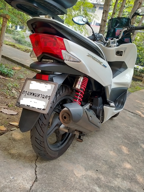

Anyway, I just changed my rear tire into 110/70 instead.

First of all, I have to say, "Wow, that is dedication to finding the answers!".
Thank you both for finding the answers to this question, which I might add, has been asked by more than a few PCX owners.
Next:
dantedmc3, it is possible on your particular 2015 model that the manufacturer kept the forks that were produced for the 2013 and before models, since the 2015 model was built when Honda was in transition to the newer design. They did not stop their assembly lines during the transition, but instead incorporated changes as the line progressed. Therefore, some 2015 models had not even had their lighting switched to LEDs yet, while others were completely changed over. My service manual says that it is for 2013 - 2017, and has pages in each section for 'after 2013'... but to service the 2015 model you might end up going back and forth within the pages in each section.
With that said, I believe the 2018 and above model was completely redesigned, so I would have been surprised if the rims had worked.
alx123, I would have to conclude from those pictures that it would be dangerous to install the larger rims on an older model PCX. Imagine getting ANYTHING caught between the rim and the swingarm. Ugh! I would not even want to imagine what would happen then.
I would conclude from this investigation that if you want larger tires on your older bike, then buy the ones that will fit on your present rims. Otherwise you are courting danger.

It is dangerous. I don't know who owns the PCX on that photo but next time I see him I feel like I need to at least let him know of the danger.
I think increasing the tire size using the original rim is ideal. as long as you don't go too wide.
My 110/70 look and feel okay, though it is quite lower than the original 100/90. I'm sure a 120 would still be possible, as someone posted it here before, but it will be a little too wide for the rim that it might squeeze the tire a little.
A 110/80 would be perfect, as it will be closer to the original tire's height.
